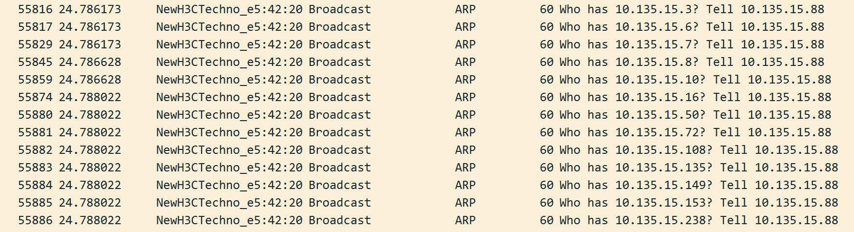

一台H3C5560交换机做二层交换机用,只在interface vlan下配置了地址10.135.15.88做管理地址用,抓包发现该交换机每隔一秒钟就会向同网段内的其他IP地址发送大量ARP请求,该网段只做二层交换机的管理地址用,不同交换机之间也无通信需求,且查看交换机的ARP表项,也都有相关IP地址的ARP信息,请求专家解释一下

查看交换机没有多余配置,也没有手动启用ARP snooping功能,且网络环境为大二层环境,该ARP请求会在全网同网段的二层交换机之间发送广播,导致全网的同网段二层交换机都产生了广播风暴告警,目前不影响业务,但存在很大的二层隐患

上配置看下
交换机业务有影响吗
<5F-WAIwang>dis cu # version 7.1.070, Release 6126P20 # sysname 5F-WAIwang # clock timezone beijing add 08:00:00 clock protocol none # telnet server enable # irf mac-address persistent timer irf auto-update enable undo irf link-delay irf member 1 priority 1 # lldp global enable # password-recovery enable # vlan 1 # vlan 7 to 10 # vlan 12 # vlan 16 # vlan 21 # stp global enable # interface NULL0 # interface Vlan-interface16 ip address 10.135.15.88 255.255.255.0 # interface GigabitEthernet1/0/1 port access vlan 16 shutdown stp edged-port # interface GigabitEthernet1/0/2 port access vlan 7 # interface GigabitEthernet1/0/3 port access vlan 12 # interface GigabitEthernet1/0/4 port access vlan 12 # interface GigabitEthernet1/0/5 port access vlan 12 # interface GigabitEthernet1/0/6 port access vlan 12 # interface GigabitEthernet1/0/7 port access vlan 21 # interface GigabitEthernet1/0/8 port access vlan 12 # interface GigabitEthernet1/0/9 port access vlan 21 # interface GigabitEthernet1/0/10 port access vlan 12 # interface GigabitEthernet1/0/11 port access vlan 12 # interface GigabitEthernet1/0/12 port access vlan 12 # interface GigabitEthernet1/0/13 port access vlan 12 # interface GigabitEthernet1/0/14 port access vlan 12 # interface GigabitEthernet1/0/15 port access vlan 7 # interface GigabitEthernet1/0/16 port access vlan 12 # interface GigabitEthernet1/0/17 description yjh port access vlan 12 # interface GigabitEthernet1/0/18 port access vlan 7 # interface GigabitEthernet1/0/19 description to D29 port access vlan 12 # interface GigabitEthernet1/0/20 description to D30 port access vlan 12 # interface GigabitEthernet1/0/21 description to D31 port access vlan 12 # interface GigabitEthernet1/0/22 description to D32 port access vlan 12 # interface GigabitEthernet1/0/23 description to D34 port access vlan 21 speed 1000 duplex full # interface GigabitEthernet1/0/24 description to D35 port access vlan 12 # interface GigabitEthernet1/0/25 description to D36 port access vlan 12 # interface GigabitEthernet1/0/26 description to D20 port access vlan 12 # interface GigabitEthernet1/0/27 description to D2 port access vlan 21 # interface GigabitEthernet1/0/28 description to D11 port access vlan 12 # interface GigabitEthernet1/0/29 port access vlan 12 # interface GigabitEthernet1/0/30 port access vlan 16 # interface GigabitEthernet1/0/31 description to D80 port access vlan 21 # interface GigabitEthernet1/0/32 description to hejingling port access vlan 21 # interface GigabitEthernet1/0/33 description to D9 port access vlan 12 # interface GigabitEthernet1/0/34 description TO N65 port access vlan 12 # interface GigabitEthernet1/0/35 description to D104 port access vlan 12 # interface GigabitEthernet1/0/36 description to D15 port access vlan 12 # interface GigabitEthernet1/0/37 description to D105 port access vlan 12 # interface GigabitEthernet1/0/38 description D27-LvJJ port access vlan 12 # interface GigabitEthernet1/0/39 port access vlan 12 # interface GigabitEthernet1/0/40 port access vlan 8 # interface GigabitEthernet1/0/41 port access vlan 12 # interface GigabitEthernet1/0/42 port access vlan 16 # interface GigabitEthernet1/0/43 port access vlan 12 # interface GigabitEthernet1/0/44 port access vlan 12 # interface GigabitEthernet1/0/45 port access vlan 21 # interface GigabitEthernet1/0/46 port access vlan 12 # interface GigabitEthernet1/0/47 port access vlan 7 # interface GigabitEthernet1/0/48 port access vlan 7 # interface M-GigabitEthernet0/0/0 # interface Ten-GigabitEthernet1/0/49 port link-type trunk port trunk permit vlan all # interface Ten-GigabitEthernet1/0/50 # interface Ten-GigabitEthernet1/0/51 # interface Ten-GigabitEthernet1/0/52 # scheduler logfile size 16 # line class aux user-role network-admin # line class usb user-role network-admin # line class vty user-role network-operator # line aux 0 user-role network-admin # line vty 0 4 authentication-mode scheme user-role network-operator # line vty 5 63 user-role network-operator # ip route-static 0.0.0.0 0 10.135.15.10 # snmp-agent snmp-agent local-engineid 800063A28004D7A5E5421A00000001 snmp-agent community read JSEGC%() snmp-agent sys-info version all # ssh server enable ssh user admin service-type stelnet authentication-type password # ntp-service enable ntp-service unicast-server 10.135.15.10 # radius scheme system user-name-format without-domain # domain system # domain default enable system # role name level-0 description Predefined level-0 role # role name level-1 description Predefined level-1 role # role name level-2 description Predefined level-2 role # role name level-3 description Predefined level-3 role # role name level-4 description Predefined level-4 role # role name level-5 description Predefined level-5 role # role name level-6 description Predefined level-6 role # role name level-7 description Predefined level-7 role # role name level-8 description Predefined level-8 role # role name level-9 description Predefined level-9 role # role name level-10 description Predefined level-10 role # role name level-11 description Predefined level-11 role # role name level-12 description Predefined level-12 role # role name level-13 description Predefined level-13 role # role name level-14 description Predefined level-14 role # user-group system # local-user admin class manage password hash $h$6$wi+2zi9+yKRrIpQm$wVGUy1hVOl40Xb1D4NkUeJm6fQds8kWcOrjLLC6ZODXDnYLW9yzIpA7hjLVXZ1APCV6zUdAEuppj2yushcL6rg== service-type telnet ssh authorization-attribute user-role network-admin authorization-attribute user-role network-operator # return
