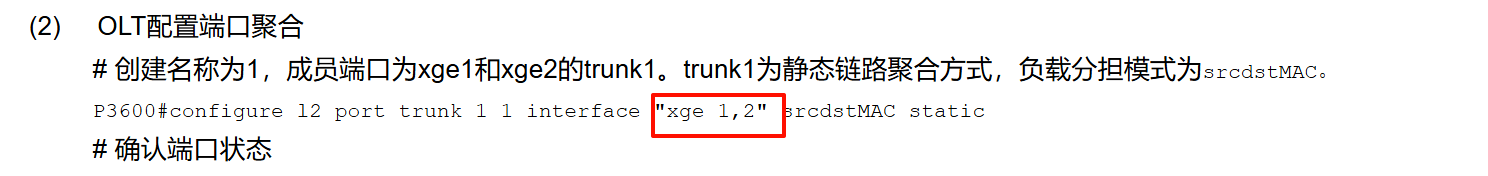

P3608(CONFIG/L2)#port trunk 1 1 interface
XGE 1 和 XGE 5 做静态聚合 这么写 (我这样写报错 port trunk 1 1 interface "xge 1.5" srcdstMAC static 在那个红色那个地方报错)
interface              - trunk group interface is a string wrapped around with "",and specified with these kinds of Ethernet ports:<xge|is>.(e.g. "is 1/1,xge 1");
                            xge x  (where x = 1 .. 8)
                            is x/y (where x = 1 .. 8, y = 1 .. 8)
                          Use '-' to specify consecutive indices (e.g. xge 1-3; is 1/1-1/3);
                          Use ',' to separate non-consecutive indices (e.g. xge 1,3; is 1/1,1/3);
                          When using '-' or ',', there is no space around it. (e.g. "is 8/1 , 8/2", "xge 1 -3", these are illegal);
                          There is at most one 'is' or 'xge' existed within the string .(e.g. "is 8/1,is 8/2,xge 1,2", this is illegal).
 是,逗号不是.
port trunk 1 1 interface "xge 1,5" srcdstMAC static
好了
