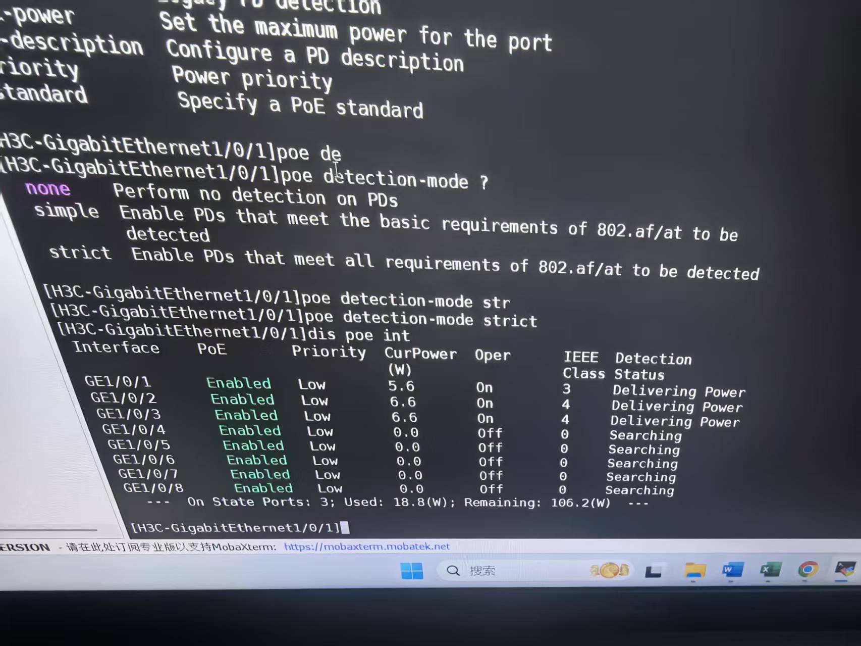

这个设备产品介绍中支持POE+   最大30W供电,但是接AP无法达到30W的功率,class 为4但是还是6.6W的功率,是版本问题吗?还是有什么命令能支持。

[H3C-GigabitEthernet1/0/1]dis thi # interface GigabitEthernet1/0/1 # return [H3C-GigabitEthernet1/0/1] [H3C-GigabitEthernet1/0/1] [H3C-GigabitEthernet1/0/1]dis poe int gi 1/0/1 PoE Status : Disabled Power Priority : Low Oper : Off IEEE Class : 0 Detection Status : Disabled Power Mode : Signal Current Power : 0 mW Average Power : 0 mW Peak Power : 0 mW Max Power : 30000 mW Electric Current : 0 mA Voltage : 0.0 V PD Description : Legacy PD Detection : Disabled PoE force power Status : Disabled [H3C-GigabitEthernet1/0/1] [H3C-GigabitEthernet1/0/1] [H3C-GigabitEthernet1/0/1]poe standard at The operation is not supported. [H3C-GigabitEthernet1/0/1] 提示我不支持该命令
八瓜 发表时间:2025-05-14
