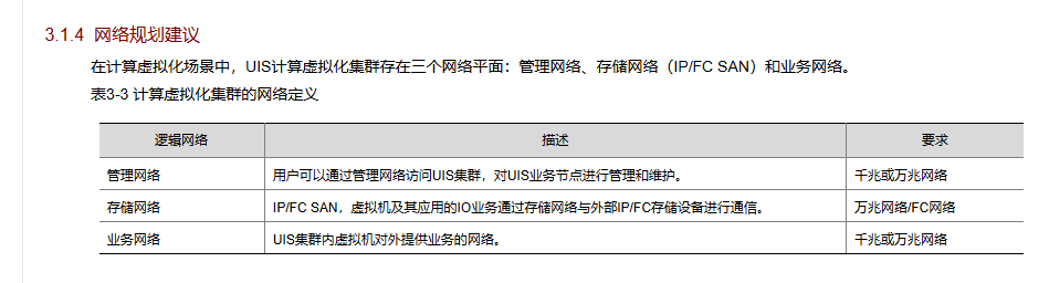

可以看看安装指导哦
https://www.h3c.com/cn/d_202504/2410581_30005_81.htm
