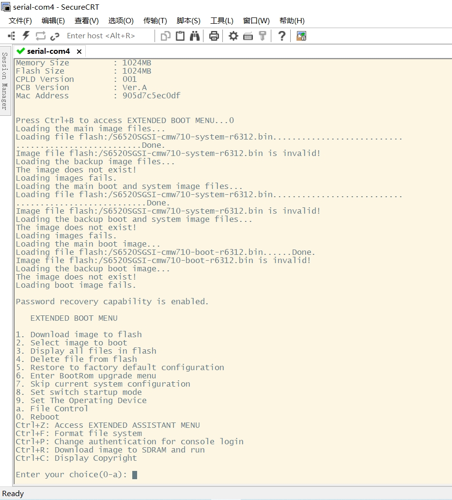

交换机S6520-22SG-SI镜像文件加载失败,哪里可以下载到该交换机的镜像文件
2025-07-16提问
  • 0收藏,1192浏览
Press Ctrl+B to access EXTENDED BOOT MENU...0
Loading the main image files...
Loading file flash:/S6520SGSI-cmw710-system-r6312.bin...........................
..........................Done.
Image file flash:/S6520SGSI-cmw710-system-r6312.bin is invalid!
Loading the backup image files...
The image does not exist!
Loading images fails.
Loading the main boot and system image files...
...........................Done.
Loading the backup boot and system image files...
Loading the main boot image...
Loading file flash:/S6520SGSI-cmw710-boot-r6312.bin......Done.
Image file flash:/S6520SGSI-cmw710-boot-r6312.bin is invalid!
Loading the backup boot image...
Loading boot image fails.
