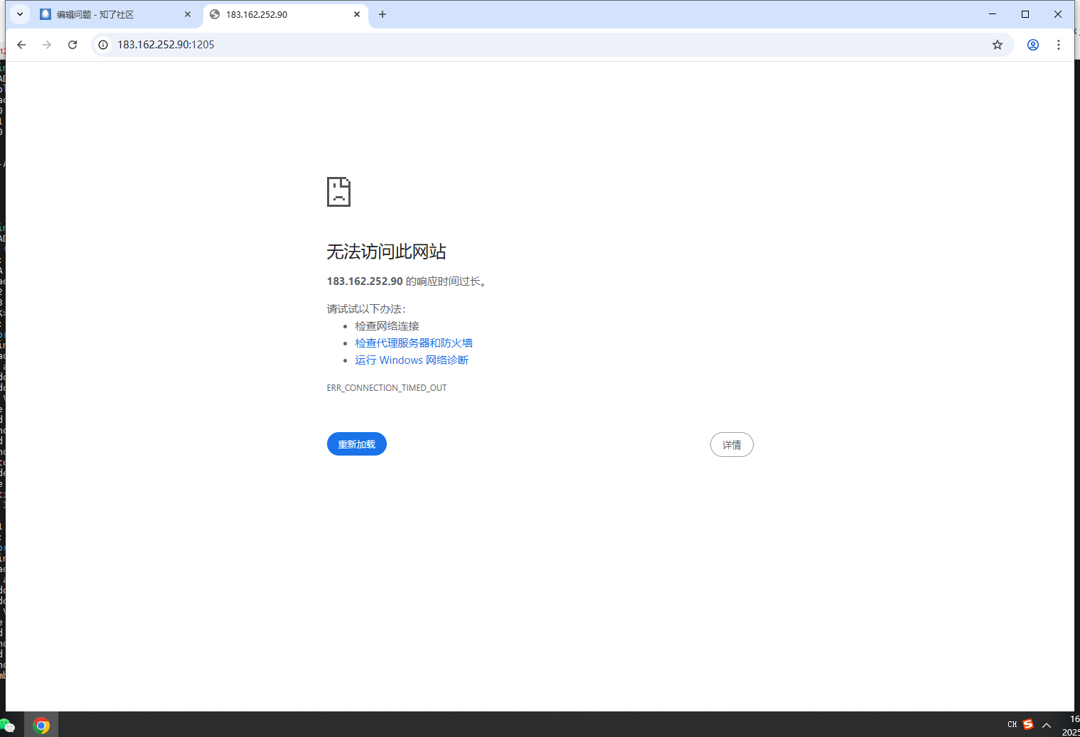

sslvpn访问不了
2025-08-01提问
  • 0收藏,3685浏览
dis cu
 version 7.1.064, Ess 8560P1619

 category Pre-PropertyDeveloper action permit logging
 category Pre-RealEstateInformation action permit logging
 category Pre-Religion action permit logging
 category Pre-SchoolCheating action permit logging
 category Pre-ScientificResearch action permit logging
 category Pre-SearchEngineAndPortal action permit logging
 category Pre-Service action permit logging
 category Pre-SexualHealth action permit logging
 category Pre-Ships action permit logging
 category Pre-ShoppingGuide action permit logging
 category Pre-SocialIssue action permit logging
 category Pre-SoftwareDownload action permit logging
 category Pre-SoftwareTechnologies action permit logging
 category Pre-SoftwareUpdate action permit logging
 category Pre-Spam action permit logging
 category Pre-SpecialFieldOrganization action permit logging
 category Pre-SpecialIndustries action permit logging
 category Pre-Sports action permit logging
 category Pre-Suicide action permit logging
 category Pre-Tattoos action permit logging
 category Pre-TeenagersAndChildren action permit logging
 category Pre-Ticket action permit logging
 category Pre-TicketAndHotel action permit logging
 category Pre-Tobacco action permit logging
 category Pre-Toys action permit logging
 category Pre-TrainingInstitutions action permit logging
 category Pre-TranslationBypass action permit logging
 category Pre-TravelGuide action permit logging
 category Pre-VehicleRent action permit logging
 category Pre-VideoConference action permit logging
 category Pre-Violence action permit logging
 category Pre-VOIP action permit logging
 category Pre-Vulgar action permit logging
 category Pre-Weapons action permit logging
 url-reputation enable
url-filter signature auto-update
 update schedule daily start-time 02:00:00 tingle 120
ips signature auto-update
app-profile 0_IPv4
 ips apply policy ips mode protect
 anti-virus apply policy av mode protect
inspect logging parameter-profile av_logging_default_parameter
 undo log syslog
inspect logging parameter-profile ips_logging_default_parameter
 undo log syslog
 log language chinese
inspect logging parameter-profile url_logging_default_parameter
inspect email parameter-profile mailsetting_default_parameter
 undo authentication enable
sslvpn ip address-pool sslvpn-pool 19.46.10.2 19.46.10.254
sslvpn gateway wangguan
 ip address 183.162.252.90 port 1205
 service enable
sslvpn context sslvpn
 gateway wangguan
 ip-tunnel interface SSLVPN-AC1
 ip-tunnel address-pool sslvpn-pool mask 255.255.255.0
 ip-route-list luyou
  include 192.168.200.0 255.255.255.0
 policy-group 1
  filter ip-tunnel acl 3001
  ip-tunnel access-route ip-route-list luyou
 force-logout max-onlines enable
 service enable
ip-reputation
 global enable
security-policy ip
 rule 4 name IPsec_swpark_10_20230616143103_IN
  parent-group vpn
  action pass
  destination-zone Local
  service ike
  service nat-t-ipsec
  service ipsec-ah
  service ipsec-esp
 rule 5 name l2tp
  parent-group vpn
  description l2tp
  action pass
  source-zone vpn
  destination-zone Trust
  source-ip l2tpaddr
  destination-ip intranet
 rule 6 name l2tpdial
  parent-group vpn
  action pass
  source-zone Untrust
  service l2tp
 rule 0 name Security_policy_0
  action pass
  profile 0_IPv4
  source-zone Local
  source-zone Untrust
  source-ip-host 125.124.219.163
 rule 3 name appserver
  parent-group haojing
  action pass
  destination-ip appserver
  service appport
 rule 2 name internet
  action pass
  source-zone Local
  source-zone Trust
 rule 8 name Intranet
  action pass
  source-ip intranet
 rule 7 name test
  action pass
  disable
 group name vpn from IPsec_swpark_10_20230616143103_IN to l2tpdial
 group name haojing from appserver to Intranet
dac log-collect service dpi reputation enable
ips policy ips
 severity-level medium high critical
ips logging parameter-profile ips_logging_default_parameter
anti-virus policy av
 inspect smtp action block
 inspect pop3 action block
 cloud-query enable
anti-virus signature auto-update
anti-virus logging parameter-profile av_logging_default_parameter
url-reputation signature auto-update
domain-reputation
 global enable
domain-reputation signature auto-update
ip-reputation signature auto-update
 cloud-management server domain ***.***
return
检查下终端到sslvpn网关的端口号通吗
粉丝:7人 关注:1人
先进入你拨号成功的客户单
cmd中输入
Route print
看下访问你sslvpn资源段的路由是否已经生效
如果生效了就不是配置问题,去找对应资源服务器去,可能是他们没有写具体的回程路由
粉丝:0人 关注:2人
拨号有没有成功,有没有获取到地址?
SSL VPN连接后无法访问内部资源,以下是排查要点,请参考: 1、检查SSL VPN网关是否有将SSL VPN网段在路由内向内网发布。 2、检查SSL VPN的资源控制策略是否做了限制。 3、检查内部网络是否有去往SSL VPN网关的路由。
无论云泥意贯一 发表时间:2025-08-01 更多>>
