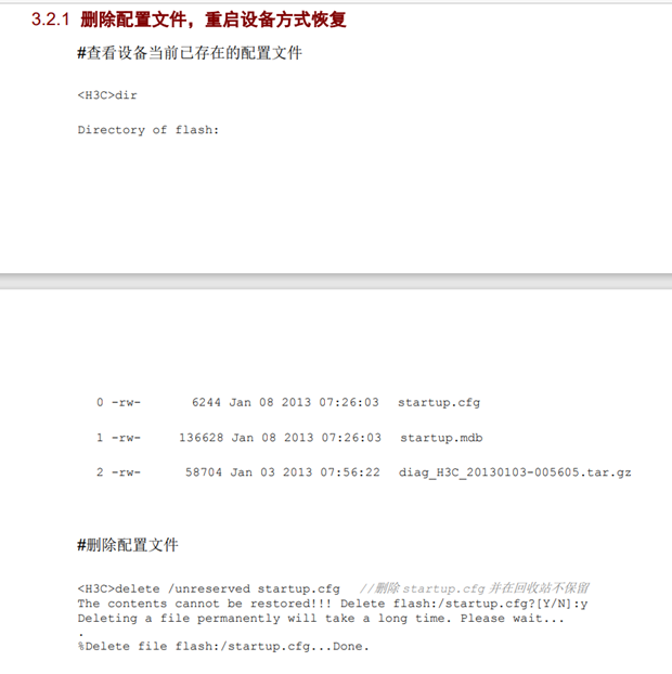

用这个命令删除内存
<H3C>delete /unreserved startup.cfg The file cannot be restored. Delete flash:/startup.cfg? [Y/N]:y Deleting the file permanently will take a long time. Please wait... Deleting file flash:/startup.cfg... Done. <H3C>boot-loader file flash:/MSG360_4-CMW710-R5480.ipe main Verifying the file flash:/MSG360_4-CMW710-R5480.ipe on the device...................................Done. H3C MSG360-4-PWR images in IPE: boot.bin system.bin ap.bin This command will set the main startup software images. Continue? [Y/N]:y Add images to the device. File flash:/boot.bin already exists on the device. File flash:/system.bin already exists on the device. File flash:/ap.bin already exists on the device. Overwrite the existing files? [Y/N]:y Decompressing file boot.bin to flash:/boot.bin.......Done. Decompressing file system.bin to flash:/system.bin...............................................Done. Decompressing file ap.bin to flash:/ap.bin...........................................Done. Decompression completed. You are recommended to delete the .ipe file after you set startup software images for all slots. Do you want to delete flash:/MSG360_4-CMW710-R5480.ipe now? [Y/N]:y flash:/boot.bin on the device is corrupted. flash:/system.bin on the device is corrupted. flash:/ap.bin on the device is corrupted. <H3C>dir%Sep 13 06:54:39:177 2025 H3C NTP/5/NTP_STRATUM_CHANGE: System stratum changed from 3 to 2 after clock update. reboot Start to check configuration with next startup configuration file, please wait.........DONE! Current configuration may be lost after the reboot, save current configuration? [Y/N]:y Please input the file name(*.cfg)[flash:/startup.cfg] (To leave the existing filename unchanged, press the enter key): Validating file. Please wait... Configuration is saved to device successfully. This command will reboot the device. Continue? [Y/N]:y Now rebooting, please wait... The specified boot file does not exist.
