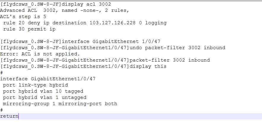

[flydcsws_0.SW-8-JF]display acl 3002 Advanced ACL 3002, named -none-, 2 rules, ACL's step is 5 rule 20 deny ip destination 103.127.126.228 0 logging rule 30 permit ip [flydcsws_0.SW-8-JF]interface GigabitEthernet 1/0/47 [flydcsws_0.SW-8-JF-GigabitEthernet1/0/47]undo packet-filter 3002 inbound Error: ACL is not applied. [flydcsws_0.SW-8-JF-GigabitEthernet1/0/47]packet-filter 3002 inbound [flydcsws_0.SW-8-JF-GigabitEthernet1/0/47]display this # interface GigabitEthernet1/0/47 port link-type hybrid port hybrid vlan 10 tagged port hybrid vlan 1 untagged mirroring-group 1 mirroring-port both # return

你好上面是我的配置输出 我这边在下面评论放了截图 你这边看看

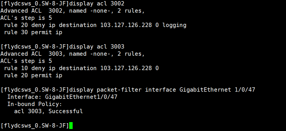

<flydcsws_0.SW-8-JF>system-view System View: return to User View with Ctrl+Z. [flydcsws_0.SW-8-JF]interface GigabitEthernet 1/0/47 [flydcsws_0.SW-8-JF-GigabitEthernet1/0/47]undo packet-filter 3003 inbound [flydcsws_0.SW-8-JF-GigabitEthernet1/0/47]packet-filter 3002 outbound

你好  配置ACL  ACL开启日志记录功能 目的是想查看触发ACL的终端 现在是端口应用不上配置的ACL  ACL去掉logging参数可以应用上
