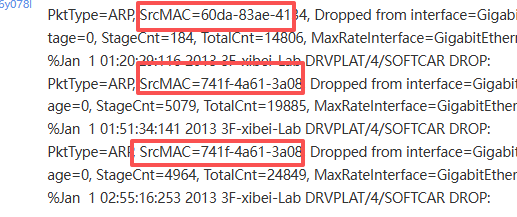

%Jan  1 00:47:55:167 2013 3F-xibei-Lab DRVPLAT/4/SOFTCAR DROP:
PktType=ARP, SrcMAC=60da-83ae-4134, Dropped from interface=GigabitEthernet1/0/26 at Stage=0, StageCnt=184, TotalCnt=14806, MaxRateInterface=GigabitEthernet1/0/26.
%Jan  1 01:20:29:116 2013 3F-xibei-Lab DRVPLAT/4/SOFTCAR DROP:
PktType=ARP, SrcMAC=741f-4a61-3a08, Dropped from interface=GigabitEthernet1/0/25 at Stage=0, StageCnt=5079, TotalCnt=19885, MaxRateInterface=GigabitEthernet1/0/26.
%Jan  1 01:51:34:141 2013 3F-xibei-Lab DRVPLAT/4/SOFTCAR DROP:
PktType=ARP, SrcMAC=741f-4a61-3a08, Dropped from interface=GigabitEthernet1/0/25 at Stage=0, StageCnt=4964, TotalCnt=24849, MaxRateInterface=GigabitEthernet1/0/26.
%Jan  1 02:55:16:253 2013 3F-xibei-Lab DRVPLAT/4/SOFTCAR DROP:

上述六步已经排查完毕,但都没有检查出问题,后续请问还可以怎么排查
这不有源mac追一下看看, 业务有没有问题?
有12台机器经过汇聚,到有问题的交换机A都会报错,有丢包
