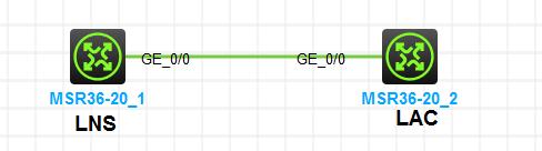

一直报这个错误:
%Nov 22 15:40:42:320 2025 r2 IFNET/3/PHY_UPDOWN: Physical state on the interface Virtual-Access0 changed to up.
%Nov 22 15:40:42:324 2025 r2 IFNET/5/LINK_UPDOWN: Line protocol state on the interface Virtual-Access0 changed to up.
%Nov 22 15:40:42:324 2025 r2 IFNET/5/LINK_UPDOWN: Line protocol state on the interface Virtual-Access0 changed to down.
%Nov 22 15:40:42:338 2025 r2 IFNET/3/PHY_UPDOWN: Physical state on the interface Virtual-Access0 changed to down.
LNS配置:
 ip pool 1 10.55.13.1 10.55.13.254
 ip pool 1 gateway 10.55.13.254
interface Virtual-Template1
 ppp authentication-mode pap domain dzj
 remote address pool 1
 ip address 10.55.12.254 255.255.255.0
interface GigabitEthernet0/0
 ip address 10.1.1.2 255.255.255.0
domain dzj
 authentication ppp local
local-user dzj class network
 password cipher 123456
 service-type ppp
 l2tp enable
l2tp-group 1 mode lns
 allow l2tp virtual-template 1
 undo tunnel authentication
LAC配置:
 l2tp enable
l2tp-group 1 mode lac
 lns-ip 10.1.1.2
interface Virtual-PPP0
 ppp pap local-user dzj password cipher 123456
 ip address 10.55.13.1 255.255.255.0
 l2tp-auto-client l2tp-group 1
VT虚接口一直在up down,建议排查如下:
1、请检查是否配置VPN的拨号账户的用户名、密码是否正确
2、请确认已经正确调用了ip pool的地址池。
3、请确认客户端那边已经做好了ip address ppp-negotiate配置
粉丝:45人 关注:1人
