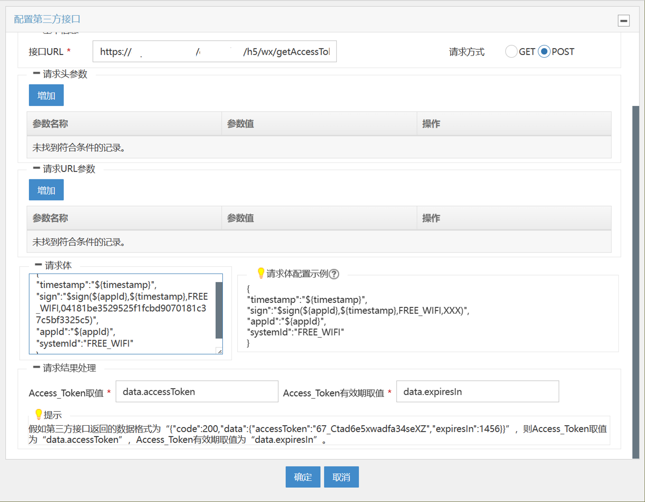

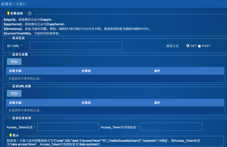

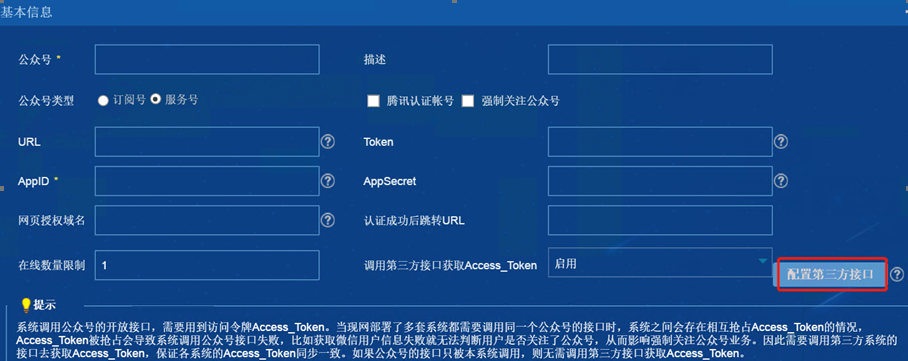

EIA较新版本增加了【调用第三方接口获取Access_Token】功能:
需要根据现场提供的http接口文档进行配置,举例现场接口文档部分内容如下:
接口URL是:***.***/xxxx/h5/wx/getAccessToken
请求方式是:POST
请求体是:{"timestamp":"20231102172212","sign":"e41f57a91d6a64a371082c74229faa22","appId":"wx89a3236f5a389b88","systemId":"FREE_WIFI"}
响应结果是:
         "msg": "操作成功",
         "code": 200,
         "data": {
                   "accessToken": "74_U9yH3mLPqJ5vpimJvdKsaPuwTeBgDXhGNasepzdM9hyVdYRgc2FWbAcRvClsX3eblEqPr9Czy27ufZ4gpZ3gXuWyIaVpuhDAgH4y78ZkCLv2llOmAL8D4he1GF0KFSdAAAYTG",
                   "expiresIn": 2904
则在iMC侧配置如下:
接口URL配置:***.***/xxxx/h5/wx/getAccessToken
请求方式选POST
请求体输入框配置:{"timestamp":"${timestamp}","sign":"$sign(${appId},${timestamp},FREE_WIFI,04181be3529525f1fcbd9070181c37c5bf3325c5)","appId":"${appId}","systemId":"FREE_WIFI"}
Access_Token取值:data.accessToken
Access_Token有效期取值:data.expiresIn
其中注意红字部分要替换成现场实际给的accessKey
