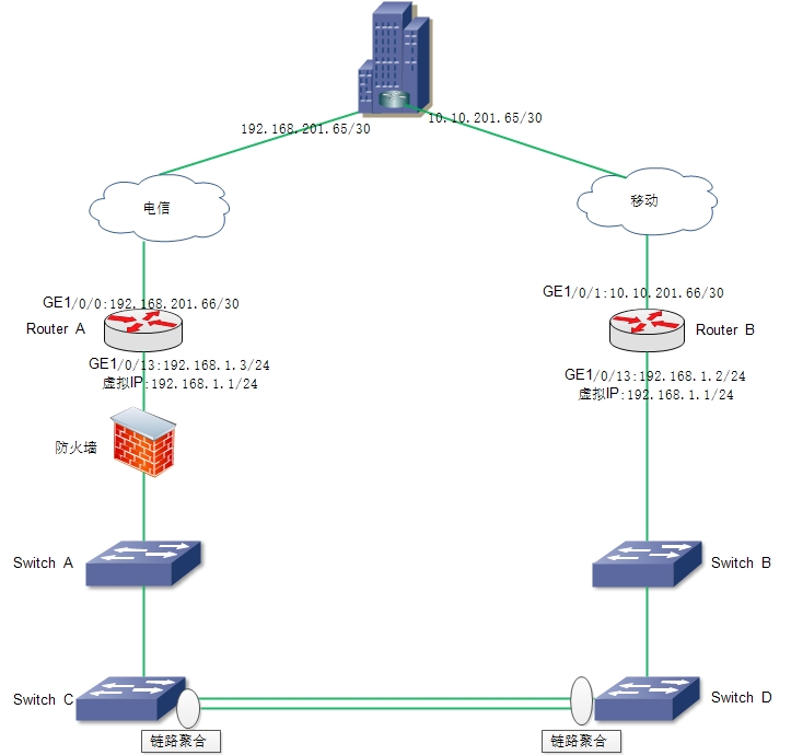

vrrp 双主 故障
2025-12-26提问
  • 0收藏,1520浏览
两台软硬件相同的H3C 应用交付网关A和B做vrrp热备,优先级低的备用设备也为master状态,出现双主故障,找不到故障原因。防火墙厂家工程师加了vrrp协议放通策略,或者路由设备A不连接防火墙还是双主故障,交换机A和B是非网管交换机,交换机C和D为H3C S5130V2 ,做的静态链路聚合。两个路由器之间ping测试,数据延迟平均值:20~30ms,最大延迟约80ms,无丢包。
路由器A  vrrp相关配置如下:
interface GigabitEthernet1/0/0
 port link-mode route
 description dianxin
 ip address 192.168.201.66 255.255.255.252
nqa entry admin test
 type icmp-echo
  destination ip 192.168.201.65
  frequency 100
  reaction 1 checked-element probe-fail threshold-type consecutive 5 action-type trigger-only
  nqa schedule admin test start-time now lifetime forever
track 1 nqa entry admin test reaction 1
interface GigabitEthernet1/0/13
 description lan
 ip address 192.168.1.3 255.255.255.0
 vrrp vrid 1 virtual-ip 192.168.1.1 255.255.255.0
 vrrp vrid 1 priority 110
 vrrp vrid 1 track 1 priority reduced 20
路由器B相关配置如下:
 description lan
 ip address 192.168.1.2 255.255.255.0
