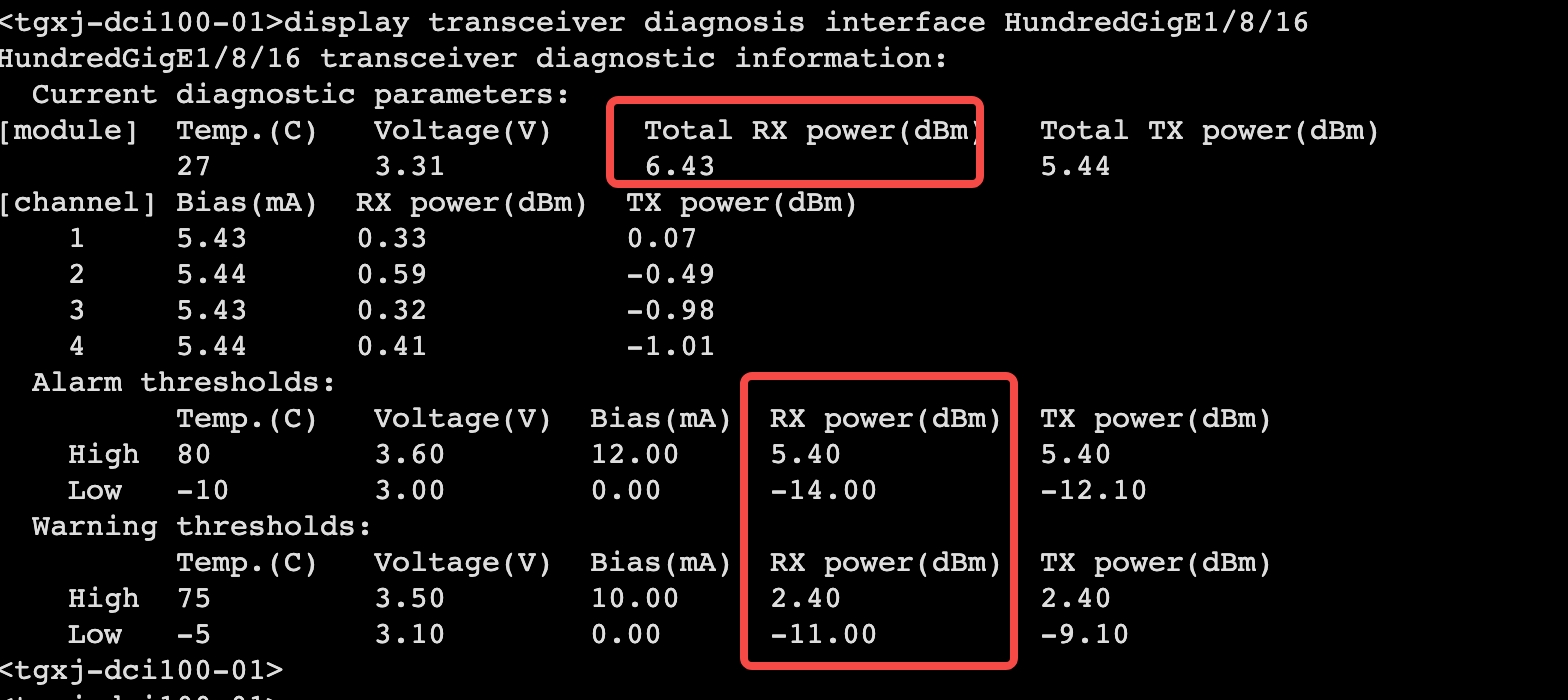

大佬们,这个光功率 RX收光预警值,是看channel通道得还是看Total RX power,应该是参考channel通道光功率吧,那么Total RX power这个是什么参数哈?

# 显示接口FortyGigE1/0/1上插入的可插拔光模块的数字诊断参数的当前测量值。
<Sysname> display transceiver diagnosis interface fortygige 1/0/1
FortyGigE1/0/1 transceiver diagnostic information:
  Current diagnostic parameters:
    Temp.(C)  Voltage(V)  Bias(mA)  RX power(dBm)  TX power(dBm)
    36        3.31        6.13      -35.64          -5.19
  Alarm thresholds:
           Temp.(C)   Voltage(V)  Bias(mA)  RX power(dBM)  TX power(dBM)
    High   50         3.55        1.44      -10.00         5.00
    Low    30         3.01        1.01      -30.00         0.00
  Warning thresholds:
           Temp(C)    Voltage(V)  Bias(mA)  RX power(dBM)  TX power(dBM)
    High   45         3.25        1.25      -15.00         4.00
    Low    25         2.85        0.85      -25.00         1.00
# 显示接口HundredGigE1/0/49上插入的QSFP28可插拔光模块的数字诊断参数的当前测量值。
<Sysname> display transceiver diagnosis interface hundredgige 1/0/49
HundredGigE1/0/49 transceiver diagnostic information:
[module]  Temp.(C) Voltage(V)     Total RX power(dBm)   Total TX power(dBm)
          38         3.32           8.35                  7.68
[channel] Bias(mA)  RX power(dBm)  TX power(dBm)
    1     41.32     2.35           1.90
    2     40.54     1.85           1.85
    3     40.85     2.23           1.22
    4     40.90     2.85           1.65
  Alarm thresholds:
    High  75         3.63        55.00     5.50           7.50
    Low   -5         2.97        25.00     -9.60          -8.30
  Warning thresholds:
    High  70         3.47        50.00     4.50           4.50
    Low   0          3.13        30.00     -8.60          -4.30

Total RX power(dBm)
数字诊断参数——总接收光功率,单位为dBm,精确到0.01dBm

RX power(dBm)
数字诊断参数——接收光功率,单位为dBm,精确到0.01dBm
