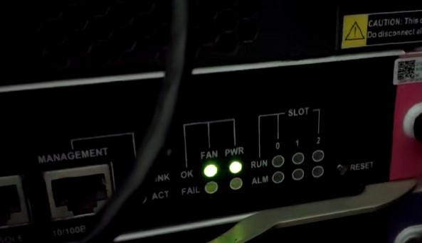

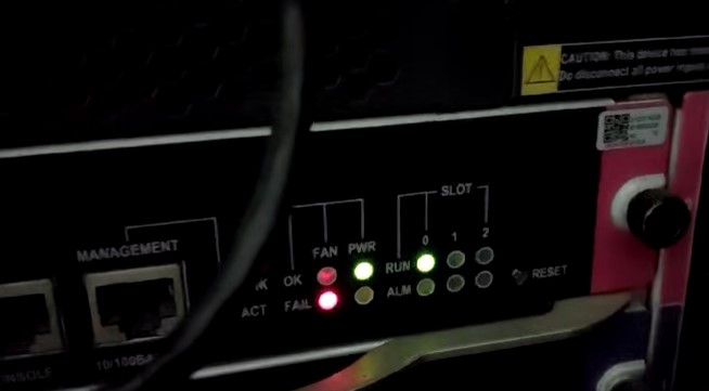

H3C S7003 面板中 Fan ok和FAIL交替闪烁
2026-04-14提问
  • 0收藏,1750浏览
<yuxin>display fan
 Fan    1 State: Fault
这是什么故障,现在设备能正常运行,我看风扇也是正常运转的

zhiliao_nfFnK5 知了小白
%Apr 15 06:50:28:927 2026 yuxin DEVM/2/FAN_FAILED: Fan 1 failed.
%Apr 15 06:50:29:727 2026 yuxin DEVM/5/FAN_RECOVERED: Fan 1 recovered.
%Apr 15 06:50:30:527 2026 yuxin DEVM/2/FAN_FAILED: Fan 1 failed.
%Apr 15 06:50:40:127 2026 yuxin DEVM/5/FAN_RECOVERED: Fan 1 recovered.
%Apr 15 06:50:40:927 2026 yuxin DEVM/2/FAN_FAILED: Fan 1 failed.
%Apr 15 06:50:50:528 2026 yuxin DEVM/5/FAN_RECOVERED: Fan 1 recovered.
%Apr 15 06:50:51:327 2026 yuxin DEVM/2/FAN_FAILED: Fan 1 failed.
%Apr 15 06:50:52:127 2026 yuxin DEVM/5/FAN_RECOVERED: Fan 1 recovered.
%Apr 15 06:50:52:927 2026 yuxin DEVM/2/FAN_FAILED: Fan 1 failed.
%Apr 15 06:51:02:528 2026 yuxin DEVM/5/FAN_RECOVERED: Fan 1 recovered.
%Apr 15 06:51:03:327 2026 yuxin DEVM/2/FAN_FAILED: Fan 1 failed.
%Apr 15 06:51:12:927 2026 yuxin DEVM/5/FAN_RECOVERED: Fan 1 recovered.
%Apr 15 06:51:13:727 2026 yuxin DEVM/2/FAN_FAILED: Fan 1 failed.
这是怎会回事
