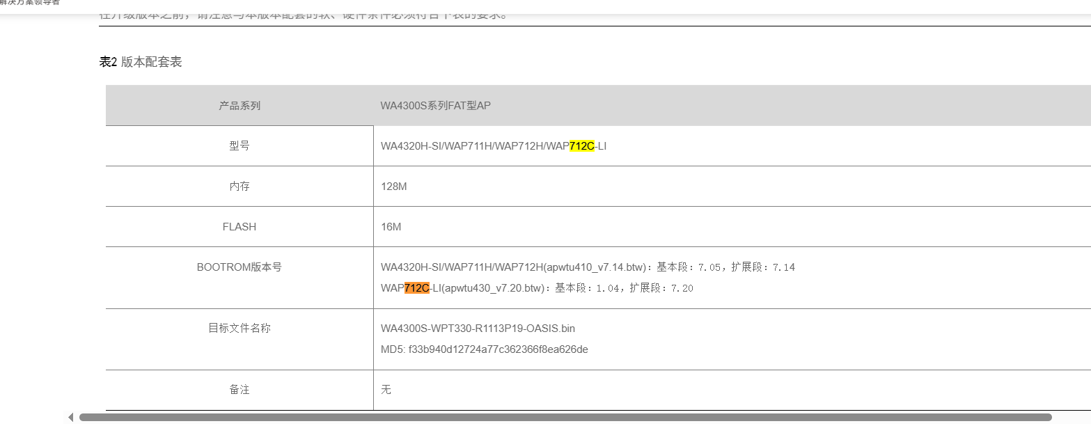

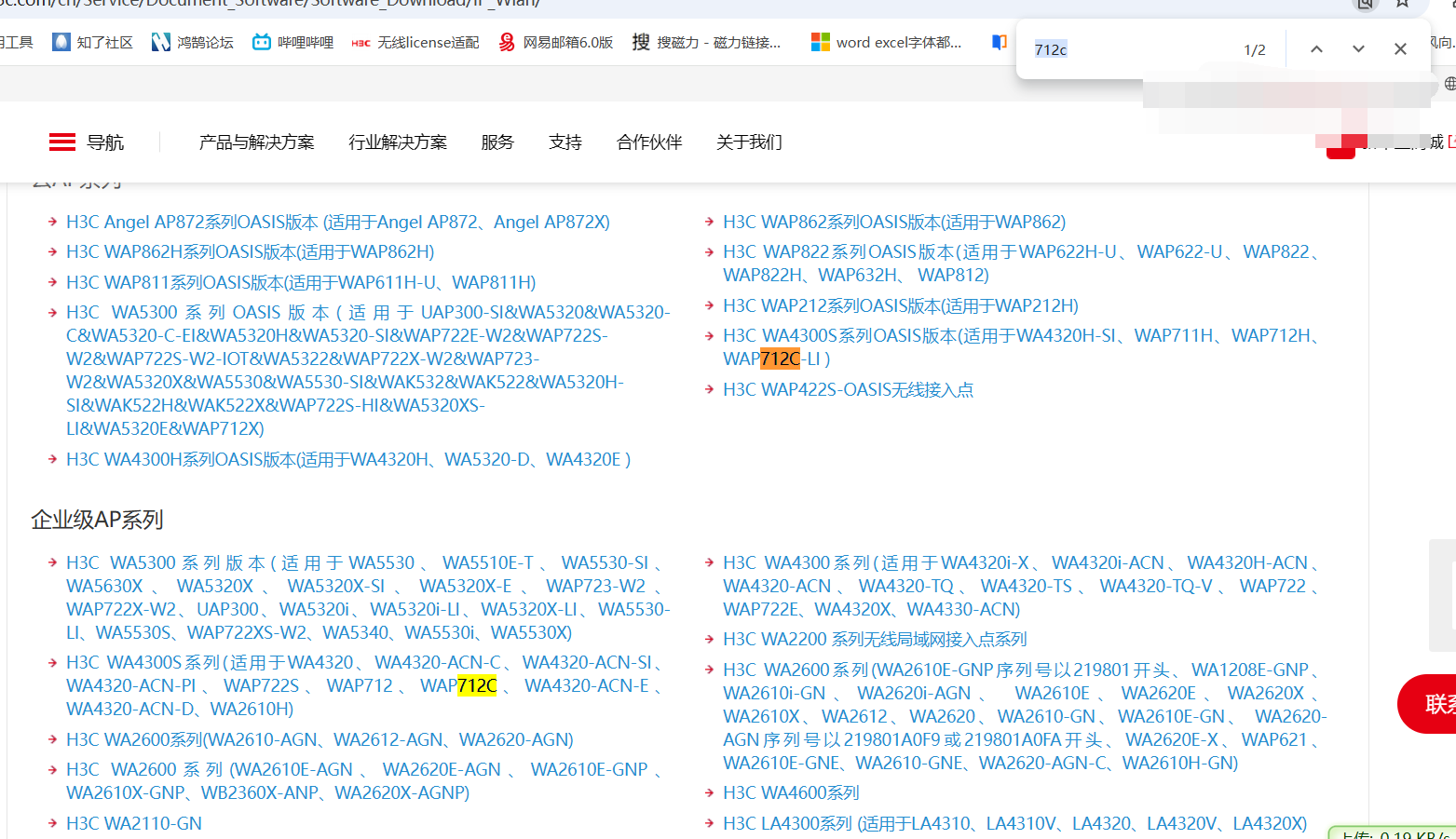

https://www.h3c.com/cn/Service/Document_Software/Software_Download/IP_Wlan/AP/H3C_WA4300S/?CHID=211283&v=612
WA4300S-CMW520-R1509P01-FAT勒个文件名。下载下来。
