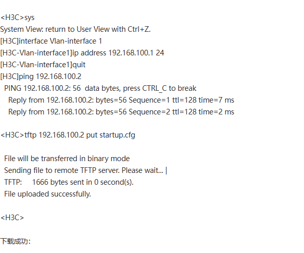

给设备和电脑配置成同网段IP地址(举例:WAC配置成192.168.100.1,电脑配置成192.168.100.2),在电脑上通过3CD软件搭建tftp服务器。
可以到本地相关路径(此例子中是E盘)查看到相关文件。

<H3C>tftp 192.168.100.20 get startup.cfg
The file startup.cfg exists. Overwrite it? [Y/N]:y
  Verifying server file...
  Deleting the old file, please wait...
  File will be transferred in binary mode
  Downloading file from remote TFTP server, please wait....
  TFTP:     1166 bytes received in 0 second(s)
  File downloaded successfully.
