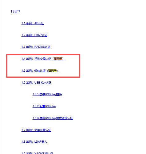

运维审计设备设置本地+手机令牌认证,登录界面还是只有本地认证
支持的 ,参考下手册:
https://www.h3c.com/cn/Service/Document_Software/Document_Center/Home/Security/00-Public/Configure/Typical_Configuration_Example/H3C_SecPath_A2000_E_Cloud_CE_R6116-29977/?CHID=1295520
