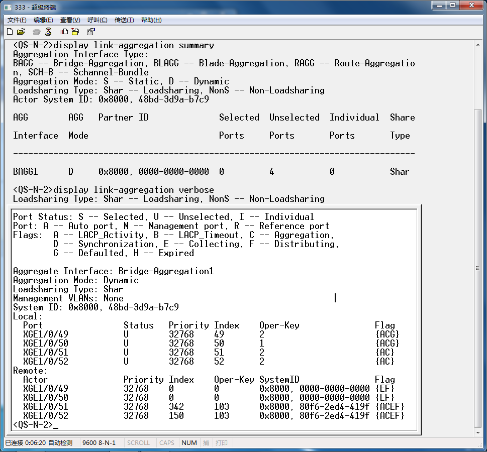

看一下物理口是不是没选中吧!
display link-aggregation summary
display link-aggregation verbose

<QS-N-2>display link-aggregation summary Aggregation Interface Type: BAGG -- Bridge-Aggregation, BLAGG -- Blade-Aggregation, RAGG -- Route-Aggregatio n, SCH-B -- Schannel-Bundle Aggregation Mode: S -- Static, D -- Dynamic Loadsharing Type: Shar -- Loadsharing, NonS -- Non-Loadsharing Actor System ID: 0x8000, 48bd-3d9a-b7c9 AGG AGG Partner ID Selected Unselected Individual Share Interface Mode Ports Ports Ports Type -------------------------------------------------------------------------------- BAGG1 D 0x8000, 0000-0000-0000 0 4 0 Shar
zhiliao_u9BoF 发表时间:2018-11-18
<QS-N-2>display link-aggregation verbose Loadsharing Type: Shar -- Loadsharing, NonS -- Non-Loadsharing Port Status: S -- Selected, U -- Unselected, I -- Individual Port: A -- Auto port, M -- Management port, R -- Reference port Flags: A -- LACP_Activity, B -- LACP_Timeout, C -- Aggregation, D -- Synchronization, E -- Collecting, F -- Distributing, G -- Defaulted, H -- Expired Aggregate Interface: Bridge-Aggregation1 Aggregation Mode: Dynamic Loadsharing Type: Shar Management VLANs: None System ID: 0x8000, 48bd-3d9a-b7c9 Local: Port Status Priority Index Oper-Key Flag XGE1/0/49 U 32768 49 2 {ACG} XGE1/0/50 U 32768 50 1 {ACG} XGE1/0/51 U 32768 51 2 {AC} XGE1/0/52 U 32768 52 2 {AC} Remote: Actor Priority Index Oper-Key SystemID Flag XGE1/0/49 32768 0 0 0x8000, 0000-0000-0000 {EF} XGE1/0/50 32768 0 0 0x8000, 0000-0000-0000 {EF} XGE1/0/51 32768 342 103 0x8000, 80f6-2ed4-419f {ACEF} XGE1/0/52 32768 150 103 0x8000, 80f6-2ed4-419f {ACEF} <QS-N-2>
好像都是“u” 都是乱的看不清楚,如果是u就是未选中的,那通信肯定不正常
一元一串 发表时间:2018-11-18

都是未选中的状态 通信怎么会正常?status变成“s”才是选中状态,看一下配置吧。聚合没有做好
