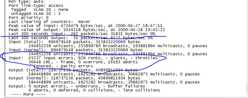

 Last 300 seconds input:  262 packets/sec 31831 bytes/sec 0%
 Last 300 seconds output:  51 packets/sec 6123 bytes/sec 0%
 Input (total):  694679148 packets, 315833220069 bytes
         244852258 unicasts, 255899789 broadcasts, 193881864 multicasts, 0 pauses
 Input (normal):  694679148 packets, 315833220069 bytes
 Input:  45237 input errors, 626 runts, - giants, - throttles
         30448 CRC, - frame, 0 overruns, 14163 aborts
         - ignored, - parity errors
 Output (total): 216737156 packets, 40899811934 bytes
         184448899 unicasts, 1625282 broadcasts, 30662975 multicasts, 0 pauses
 Output (normal): 216737156 packets, 40899811934 bytes
 Output: 0 output errors, - underruns, - buffer failures
         0 aborts, 0 deferred, 0 collisions, - late collisions
捕获
 Last 300 seconds input:  262 packets/sec 31831 bytes/sec 0% 中的 0%是负载吗,本交换机是S2626-PWR,端口带宽为100M
假如是1%,那么负载在是1M每秒吗?
另外, Input:  45237 input errors, 626 runts, - giants, - throttles
这段话中626 runts 30448CRC 16163aborts等这些帧的处理方式,是什么原因导致它们出现的呢?
最后怎么判断,一个端口负载是否过大,尤其是这个端口是级联口的情况下?
如果你想看接口当前有多少流量,就看last 300 seconds的统计,看后边的bytes字节数,例如举例的:6123 bytes/sec ,字节和比特关系是乘8,就是6123X8=48984 bit,在换算成Kbit,就是47Kb,当然这是5分钟的平均值,时间间隔有些大,也可以改成5秒的平均值,这样也可以更好的反应实时的流量,命令是[H3C]flow-interval 5
