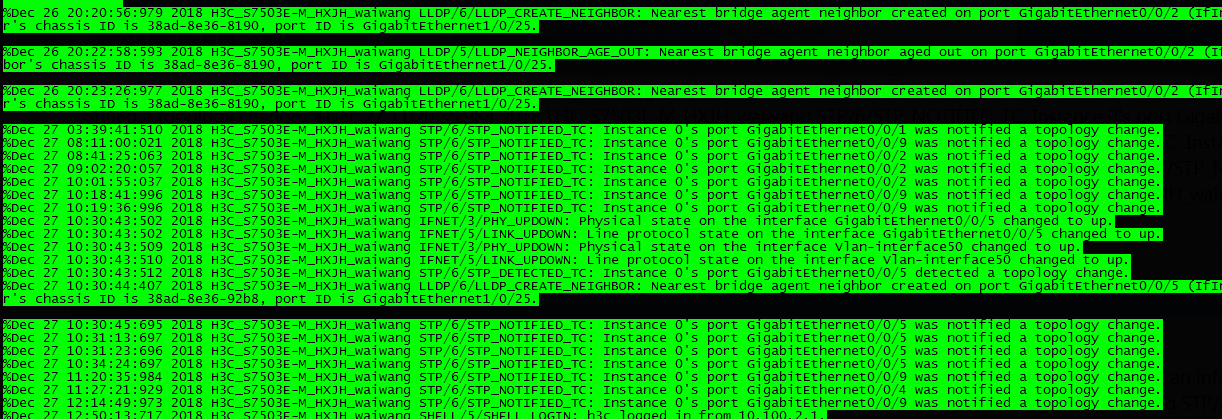

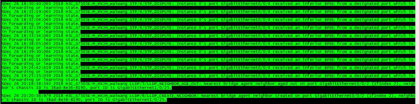

S7503E_有时候断网有时候不断 中午人上多了几断网
%Dec 26 18:30:40:065 2018 H3C_S7503E-M_HXJH_waiwang STP/4/STP_DISPUTE: Instance 0's port GigabitEthernet0/0/4 received an inferior BPDU from a designated port which is in forwarding or learning state. %Dec 26 18:31:19:065 2018 H3C_S7503E-M_HXJH_waiwang STP/4/STP_DISPUTE: Instance 0's port GigabitEthernet0/0/4 received an inferior BPDU from a designated port which is in forwarding or learning state. %Dec 26 18:32:04:065 2018 H3C_S7503E-M_HXJH_waiwang STP/4/STP_DISPUTE: Instance 0's port GigabitEthernet0/0/4 received an inferior BPDU from a designated port which is in forwarding or learning state. %Dec 26 18:32:39:065 2018 H3C_S7503E-M_HXJH_waiwang STP/4/STP_DISPUTE: Instance 0's port GigabitEthernet0/0/4 received an inferior BPDU from a designated port which is in forwarding or learning state. %Dec 26 18:33:54:065 2018 H3C_S7503E-M_HXJH_waiwang STP/4/STP_DISPUTE: Instance 0's port GigabitEthernet0/0/4 received an inferior BPDU from a designated port which is in forwarding or learning state. %Dec 26 18:38:05:065 2018 H3C_S7503E-M_HXJH_waiwang STP/4/STP_DISPUTE: Instance 0's port GigabitEthernet0/0/4 received an inferior BPDU from a designated port which is in forwarding or learning state. %Dec 26 18:39:30:064 2018 H3C_S7503E-M_HXJH_waiwang STP/4/STP_DISPUTE: Instance 0's port GigabitEthernet0/0/4 received an inferior BPDU from a designated port which is in forwarding or learning state. %Dec 26 18:40:11:064 2018 H3C_S7503E-M_HXJH_waiwang STP/4/STP_DISPUTE: Instance 0's port GigabitEthernet0/0/4 received an inferior BPDU from a designated port which is in forwarding or learning state. %Dec 26 19:24:42:419 2018 H3C_S7503E-M_HXJH_waiwang STP/4/STP_DISPUTE: Instance 0's port GigabitEthernet0/0/4 received an inferior BPDU from a designated port which is in forwarding or learning state. %Dec 26 19:25:35:059 2018 H3C_S7503E-M_HXJH_waiwang STP/4/STP_DISPUTE: Instance 0's port GigabitEthernet0/0/4 received an inferior BPDU from a designated port which is in forwarding or learning state. %Dec 26 20:18:58:593 2018 H3C_S7503E-M_HXJH_waiwang LLDP/5/LLDP_NEIGHBOR_AGE_OUT: Nearest bridge agent neighbor aged out on port GigabitEthernet0/0/2 (IfIndex 2), neighbor's chassis ID is 38ad-8e36-8190, port ID is GigabitEthernet1/0/25. %Dec 26 20:20:56:979 2018 H3C_S7503E-M_HXJH_waiwang LLDP/6/LLDP_CREATE_NEIGHBOR: Nearest bridge agent neighbor created on port GigabitEthernet0/0/2 (IfIndex 2), neighbor's chassis ID is 38ad-8e36-8190, port ID is GigabitEthernet1/0/25. %Dec 26 20:22:58:593 2018 H3C_S7503E-M_HXJH_waiwang LLDP/5/LLDP_NEIGHBOR_AGE_OUT: Nearest bridge agent neighbor aged out on port GigabitEthernet0/0/2 (IfIndex 2), neighbor's chassis ID is 38ad-8e36-8190, port ID is GigabitEthernet1/0/25. %Dec 26 20:23:26:977 2018 H3C_S7503E-M_HXJH_waiwang LLDP/6/LLDP_CREATE_NEIGHBOR: Nearest bridge agent neighbor created on port GigabitEthernet0/0/2 (IfIndex 2), neighbor's chassis ID is 38ad-8e36-8190, port ID is GigabitEthernet1/0/25. %Dec 27 03:39:41:510 2018 H3C_S7503E-M_HXJH_waiwang STP/6/STP_NOTIFIED_TC: Instance 0's port GigabitEthernet0/0/1 was notified a topology change. %Dec 27 08:11:00:021 2018 H3C_S7503E-M_HXJH_waiwang STP/6/STP_NOTIFIED_TC: Instance 0's port GigabitEthernet0/0/9 was notified a topology change. %Dec 27 08:41:25:063 2018 H3C_S7503E-M_HXJH_waiwang STP/6/STP_NOTIFIED_TC: Instance 0's port GigabitEthernet0/0/2 was notified a topology change. %Dec 27 09:02:20:057 2018 H3C_S7503E-M_HXJH_waiwang STP/6/STP_NOTIFIED_TC: Instance 0's port GigabitEthernet0/0/2 was notified a topology change. %Dec 27 10:01:55:037 2018 H3C_S7503E-M_HXJH_waiwang STP/6/STP_NOTIFIED_TC: Instance 0's port GigabitEthernet0/0/2 was notified a topology change. %Dec 27 10:18:41:996 2018 H3C_S7503E-M_HXJH_waiwang STP/6/STP_NOTIFIED_TC: Instance 0's port GigabitEthernet0/0/9 was notified a topology change. %Dec 27 10:19:36:996 2018 H3C_S7503E-M_HXJH_waiwang STP/6/STP_NOTIFIED_TC: Instance 0's port GigabitEthernet0/0/9 was notified a topology change. %Dec 27 10:30:43:502 2018 H3C_S7503E-M_HXJH_waiwang IFNET/3/PHY_UPDOWN: Physical state on the interface GigabitEthernet0/0/5 changed to up. %Dec 27 10:30:43:502 2018 H3C_S7503E-M_HXJH_waiwang IFNET/5/LINK_UPDOWN: Line protocol state on the interface GigabitEthernet0/0/5 changed to up. %Dec 27 10:30:43:509 2018 H3C_S7503E-M_HXJH_waiwang IFNET/3/PHY_UPDOWN: Physical state on the interface Vlan-interface50 changed to up. %Dec 27 10:30:43:510 2018 H3C_S7503E-M_HXJH_waiwang IFNET/5/LINK_UPDOWN: Line protocol state on the interface Vlan-interface50 changed to up. %Dec 27 10:30:43:512 2018 H3C_S7503E-M_HXJH_waiwang STP/6/STP_DETECTED_TC: Instance 0's port GigabitEthernet0/0/5 detected a topology change. %Dec 27 10:30:44:407 2018 H3C_S7503E-M_HXJH_waiwang LLDP/6/LLDP_CREATE_NEIGHBOR: Nearest bridge agent neighbor created on port GigabitEthernet0/0/5 (IfIndex 5), neighbor's chassis ID is 38ad-8e36-92b8, port ID is GigabitEthernet1/0/25. %Dec 27 10:30:45:695 2018 H3C_S7503E-M_HXJH_waiwang STP/6/STP_NOTIFIED_TC: Instance 0's port GigabitEthernet0/0/5 was notified a topology change. %Dec 27 10:31:13:697 2018 H3C_S7503E-M_HXJH_waiwang STP/6/STP_NOTIFIED_TC: Instance 0's port GigabitEthernet0/0/5 was notified a topology change. %Dec 27 10:31:23:696 2018 H3C_S7503E-M_HXJH_waiwang STP/6/STP_NOTIFIED_TC: Instance 0's port GigabitEthernet0/0/5 was notified a topology change. %Dec 27 10:34:24:697 2018 H3C_S7503E-M_HXJH_waiwang STP/6/STP_NOTIFIED_TC: Instance 0's port GigabitEthernet0/0/5 was notified a topology change. %Dec 27 11:20:35:984 2018 H3C_S7503E-M_HXJH_waiwang STP/6/STP_NOTIFIED_TC: Instance 0's port GigabitEthernet0/0/9 was notified a topology change. %Dec 27 11:27:21:929 2018 H3C_S7503E-M_HXJH_waiwang STP/6/STP_NOTIFIED_TC: Instance 0's port GigabitEthernet0/0/4 was notified a topology change. %Dec 27 12:14:49:973 2018 H3C_S7503E-M_HXJH_waiwang STP/6/STP_NOTIFIED_TC: Instance 0's port GigabitEthernet0/0/9 was notified a topology change. %Dec 27 12:50:13:717 2018 H3C_S7503E-M_HXJH_waiwang SHELL/5/SHELL_LOGIN: h3c logged in from 10.100.2.1.
feihuo 七段
粉丝:7人 关注:0人
看下是否有拥塞丢包,包丢在哪了,是不是有人电脑中毒一直在发送arp攻击
