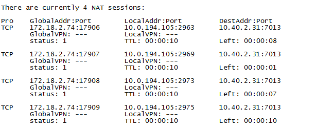

10.40.2.31不行,168.168.168.158 可以
我更改了TCP nat aging 为600S
goosy 一段
不是,查看NAT SESSION , 很清楚的显示, 就是TCP连接。
我们的路由器在大同, 10.40.这个网段是到太原的, 168.168.168.0 是大同本地。就此区别

其实我发现,不只10.40这个网段的NAT TTL, 有其他公网的IP的NAT TTL也是只有10S

NAT SESSION 中默认的TCP TTL的值是10, aging time默认是300, 这两个值也是不同?

TCP 192.168.0.194:44780 10.0.194.55:2181 42.236.37.118:80 GlobalVPN: --- LocalVPN: --- status: 1 TTL: 00:10:00 Left: 00:09:55 TCP 192.168.0.194:53058 10.0.194.55:1342 42.236.37.121:80 GlobalVPN: --- LocalVPN: --- status: 1 TTL: 00:10:00 Left: 00:09:58 TCP 192.168.0.194:61654 10.0.194.55:1441 223.167.166.60:80 GlobalVPN: --- LocalVPN: --- status: 1 TTL: 00:10:00 Left: 00:08:02 TCP 192.168.0.194:18771 10.0.194.55:3540 42.236.37.97:80 GlobalVPN: --- LocalVPN: --- status: 1 TTL: 00:00:30 Left: 00:00:12 TCP 192.168.0.194:18772 10.0.194.55:3541 42.236.37.97:80 GlobalVPN: --- LocalVPN: --- status: 1 TTL: 00:00:30 Left: 00:00:12 TCP 192.168.0.194:18775 10.0.194.55:3542 42.236.37.97:80 GlobalVPN: --- LocalVPN: --- status: 1 TTL: 00:00:30 Left: 00:00:12 TCP 192.168.0.194:18776 10.0.194.55:3543 42.236.37.97:80 GlobalVPN: --- LocalVPN: --- status: 1 TTL: 00:00:30 Left: 00:00:12 TCP 192.168.0.194:18786 10.0.194.55:3544 42.236.37.97:80 GlobalVPN: --- LocalVPN: --- status: 1 TTL: 00:00:30 Left: 00:00:12 TCP 192.168.0.194:18789 10.0.194.55:3545 42.236.37.97:80 GlobalVPN: --- LocalVPN: --- status: 1 TTL: 00:00:30 Left: 00:00:12 TCP 192.168.0.194:18790 10.0.194.55:3546 42.236.37.97:80 GlobalVPN: --- LocalVPN: --- status: 1 TTL: 00:00:30 Left: 00:00:12 TCP 192.168.0.194:18791 10.0.194.55:3547 42.236.37.97:80 GlobalVPN: --- LocalVPN: --- status: 1 TTL: 00:00:30 Left: 00:00:12 TCP 192.168.0.194:18793 10.0.194.55:3548 42.236.37.97:80 GlobalVPN: --- LocalVPN: --- status: 1 TTL: 00:00:30 Left: 00:00:12 TCP 192.168.0.194:18806 10.0.194.55:3549 42.236.37.97:80 GlobalVPN: --- LocalVPN: --- status: 1 TTL: 00:00:30 Left: 00:00:12 TCP 192.168.0.194:18807 10.0.194.55:3550 42.236.37.97:80 GlobalVPN: --- LocalVPN: --- status: 1 TTL: 00:00:30 Left: 00:00:12 TCP 192.168.0.194:18809 10.0.194.55:3551 42.236.37.97:80 GlobalVPN: --- LocalVPN: --- status: 1 TTL: 00:00:30 Left: 00:00:13 TCP 192.168.0.194:18810 10.0.194.55:3552 42.236.37.97:80 GlobalVPN: --- LocalVPN: --- status: 1 TTL: 00:00:30 Left: 00:00:13 TCP 192.168.0.194:18812 10.0.194.55:3553 42.236.37.97:80 GlobalVPN: --- LocalVPN: --- status: 1 TTL: 00:00:30 Left: 00:00:13 TCP 192.168.0.194:18821 10.0.194.55:3554 42.236.37.97:80 GlobalVPN: --- LocalVPN: --- status: 1 TTL: 00:00:30 Left: 00:00:13 TCP 192.168.0.194:18824 10.0.194.55:3555 42.236.37.97:80 GlobalVPN: --- LocalVPN: --- status: 1 TTL: 00:00:30 Left: 00:00:13 TCP 192.168.0.194:18825 10.0.194.55:3556 42.236.37.97:80 GlobalVPN: --- LocalVPN: --- status: 1 TTL: 00:00:30 Left: 00:00:14 TCP 192.168.0.194:18826 10.0.194.55:3557 42.236.37.97:80 GlobalVPN: --- LocalVPN: --- status: 1 TTL: 00:00:30 Left: 00:00:14 TCP 192.168.0.194:18974 10.0.194.55:3558 171.8.167.89:80 GlobalVPN: --- LocalVPN: --- status: 1 TTL: 00:00:30 Left: 00:00:25 TCP 192.168.0.194:55249 10.0.194.56:1176 42.236.37.137:80 GlobalVPN: --- LocalVPN: --- status: 1 TTL: 00:10:00 Left: 00:08:46 TCP 192.168.0.194:60374 10.0.194.56:1241 223.167.166.50:80 GlobalVPN: --- LocalVPN: --- status: 1 TTL: 00:10:00 Left: 00:06:15 TCP 192.168.0.194:13191 10.0.194.57:1087 42.236.37.146:80 GlobalVPN: --- LocalVPN: --- status: 1 TTL: 00:10:00 Left: 00:09:22 TCP 192.168.0.194:13228 10.0.194.57:1092 42.236.37.116:80 GlobalVPN: --- LocalVPN: --- status: 1 TTL: 00:10:00 Left: 00:08:42 TCP 192.168.0.194:17401 10.0.194.57:1324 223.167.166.50:80 GlobalVPN: --- LocalVPN: --- status: 1 TTL: 00:10:00 Left: 00:08:01 ICMP 192.168.0.194:18976 10.0.194.57:512 221.204.244.41:512 GlobalVPN: --- LocalVPN: --- status: 1 TTL: 00:00:10 Left: 00:00:08 TCP 192.168.0.194:30417 10.0.194.59:49160 42.236.37.147:80 GlobalVPN: --- LocalVPN: --- status: 1 TTL: 00:10:00 Left: 00:09:59 TCP 192.168.0.194:30565 10.0.194.59:49185 111.206.200.2:443 GlobalVPN: --- LocalVPN: --- status: 1 TTL: 00:10:00 Left: 00:06:03 TCP 192.168.0.194:30803 10.0.194.59:49243 42.236.37.138:80 GlobalVPN: --- LocalVPN: --- status: 1 TTL: 00:10:00 Left: 00:09:59 TCP 192.168.0.194:14954 10.0.194.59:50019 223.167.166.51:443 GlobalVPN: --- LocalVPN: --- status: 1 TTL: 00:05:00 Left: 00:00:31 TCP 192.168.0.194:18367 10.0.194.59:50061 111.13.100.92:443 GlobalVPN: --- LocalVPN: --- status: 1 TTL: 00:00:30 Left: 00:00:02 TCP 192.168.0.194:18513 10.0.194.59:50062 111.13.100.92:443 GlobalVPN: --- LocalVPN: --- status: 1 TTL: 00:00:30 Left: 00:00:12 TCP 192.168.0.194:18515 10.0.194.59:50063 192.168.1.6:80 GlobalVPN: --- LocalVPN: --- status: 101 TTL: 00:00:30 Left: 00:00:18 TCP 192.168.0.194:18629 10.0.194.59:50064 192.168.1.6:80 GlobalVPN: --- LocalVPN: --- status: 101 TTL: 00:00:30 Left: 00:00:10 TCP 192.168.0.194:18656 10.0.194.59:50065 111.13.100.92:443 GlobalVPN: --- LocalVPN: --- status: 1 TTL: 00:00:30 Left: 00:00:22 TCP 192.168.0.194:18811 10.0.194.59:50066 111.13.100.92:443 GlobalVPN: --- LocalVPN: --- status: 1 TTL: 00:00:30 Left: 00:00:23 TCP 192.168.0.194:18946 10.0.194.59:50067 192.168.1.6:80 GlobalVPN: --- LocalVPN: --- status: 101 TTL: 00:00:30 Left: 00:00:25 TCP 192.168.0.194:18952 10.0.194.59:50068 111.13.100.92:443 GlobalVPN: --- LocalVPN: --- status: 1 TTL: 00:00:30 Left: 00:00:28 TCP 192.168.0.194:18973 10.0.194.59:50069 192.168.1.6:80 GlobalVPN: --- LocalVPN: --- status: 101 TTL: 00:00:30 Left: 00:00:28 TCP 192.168.0.194:58023 10.0.194.61:4282 59.49.46.74:2120 GlobalVPN: --- LocalVPN: --- status: 1 TTL: 00:10:00 Left: 00:09:59 TCP 192.168.0.194:17605 10.0.194.61:4542 59.49.46.74:2120 GlobalVPN: --- LocalVPN: --- status: 1 TTL: 00:00:30 Left: 00:00:27 TCP 192.168.0.194:19027 10.0.194.61:4545 59.49.46.74:2120 GlobalVPN: --- LocalVPN: --- status: 1 TTL: 00:05:00 Left: 00:04:59 TCP 192.168.0.194:23957 10.0.194.61:3976 42.236.37.121:80 GlobalVPN: --- LocalVPN: --- status: 1 TTL: 00:10:00 Left: 00:09:48 TCP 192.168.0.194:55598 10.0.194.101:49528 116.62.181.81:443 GlobalVPN: --- LocalVPN: --- status: 1 TTL: 00:10:00 Left: 00:09:39 TCP 192.168.0.194:18615 10.0.194.106:60918 192.168.1.6:80 GlobalVPN: --- LocalVPN: --- status: 101 TTL: 00:00:30 Left: 00:00:24 TCP 192.168.0.194:18747 10.0.194.106:60919 192.168.1.6:80 GlobalVPN: --- LocalVPN: --- status: 101 TTL: 00:00:30 Left: 00:00:18 TCP 192.168.0.194:55442 10.0.194.106:60241 42.236.37.137:80 GlobalVPN: --- LocalVPN: --- status: 1 TTL: 00:10:00 Left: 00:09:47 TCP 192.168.0.194:56229 10.0.194.106:60246 42.236.37.142:80 GlobalVPN: --- LocalVPN: --- status: 1 TTL: 00:10:00 Left: 00:08:09 TCP 192.168.0.194:56735 10.0.194.106:60251 180.163.238.136:80 GlobalVPN: --- LocalVPN: --- status: 1 TTL: 00:10:00 Left: 00:08:00 TCP 192.168.0.194:53245 10.0.194.109:57384 223.167.166.59:80 GlobalVPN: --- LocalVPN: --- status: 1 TTL: 00:10:00 Left: 00:05:31 TCP 192.168.0.194:53961 10.0.194.109:57394 42.236.37.140:80 GlobalVPN: --- LocalVPN: --- status: 1 TTL: 00:10:00 Left: 00:08:37 TCP 192.168.0.194:17887 10.0.194.109:58557 211.159.235.178:80 GlobalVPN: --- LocalVPN: --- status: 1 TTL: 00:00:30 Left: 00:00:17 TCP 192.168.0.194:18703 10.0.194.109:58558 42.236.37.46:80 GlobalVPN: --- LocalVPN: --- status: 1 TTL: 00:00:30 Left: 00:00:06 TCP 192.168.0.194:56795 10.0.194.109:57871 42.236.37.110:80 GlobalVPN: --- LocalVPN: --- status: 1 TTL: 00:10:00 Left: 00:09:32 TCP 192.168.0.194:42971 10.0.194.109:58017 188.172.219.140:5938 GlobalVPN: --- LocalVPN: --- status: 1 TTL: 00:10:00 Left: 00:09:47 UDP 192.168.0.194:17474 10.0.194.109:61403 58.250.11.13:8000 GlobalVPN: --- LocalVPN: --- status: 1 TTL: 00:04:00 Left: 00:02:21 UDP 192.168.0.194:17475 10.0.194.109:61404 58.250.10.140:8000 GlobalVPN: --- LocalVPN: --- status: 1 TTL: 00:04:00 Left: 00:02:21 TCP 192.168.0.194:18261 10.0.194.111:1513 192.168.1.6:80 GlobalVPN: --- LocalVPN: --- status: 101 TTL: 00:00:30 Left: 00:00:21 TCP 192.168.0.194:18413 10.0.194.111:1516 192.168.1.6:80 GlobalVPN: --- LocalVPN: --- status: 101 TTL: 00:00:30 Left: 00:00:11 TCP 192.168.0.194:18617 10.0.194.111:1517 192.168.1.6:80 GlobalVPN: --- LocalVPN: --- status: 101 TTL: 00:00:30 Left: 00:00:10 TCP 192.168.0.194:18918 10.0.194.111:1518 192.168.1.6:80 GlobalVPN: --- LocalVPN: --- status: 101 TTL: 00:00:30 Left: 00:00:29 TCP 192.168.0.194:18934 10.0.194.111:1519 221.204.244.41:80 GlobalVPN: --- LocalVPN: --- status: 1 TTL: 00:00:30 Left: 00:00:22 TCP 192.168.0.194:18935 10.0.194.111:1520 221.204.244.40:80 GlobalVPN: --- LocalVPN: --- status: 1 TTL: 00:05:00 Left: 00:04:55 TCP 192.168.0.194:18937 10.0.194.111:1521 192.168.1.6:80 GlobalVPN: --- LocalVPN: --- status: 101 TTL: 00:00:30 Left: 00:00:25 TCP 192.168.0.194:57624 10.0.194.111:4609 223.167.166.55:80 GlobalVPN: --- LocalVPN: --- status: 1 TTL: 00:10:00 Left: 00:09:00 TCP 192.168.0.194:57766 10.0.194.111:4610 42.236.37.140:80 GlobalVPN: --- LocalVPN: --- status: 1 TTL: 00:10:00 Left: 00:09:49 UDP 192.168.0.194:18933 10.0.194.111:57978 202.99.192.68:53 GlobalVPN: --- LocalVPN: --- status: 0 TTL: 00:00:10 Left: 00:00:02 TCP 192.168.0.194:18752 192.168.222.129:52247 117.161.26.223:443 GlobalVPN: --- LocalVPN: --- status: 1 TTL: 00:00:30 Left: 00:00:10 TCP 192.168.0.194:18643 192.168.222.129:52258 117.161.26.223:443 GlobalVPN: --- LocalVPN: --- status: 1 TTL: 00:00:30 Left: 00:00:02 TCP 192.168.0.194:18715 192.168.222.129:52459 117.161.13.222:443 GlobalVPN: --- LocalVPN: --- status: 1 TTL: 00:00:30 Left: 00:00:07 TCP 192.168.0.194:54151 10.0.194.112:61482 42.236.37.137:80 GlobalVPN: --- LocalVPN: --- status: 1 TTL: 00:10:00 Left: 00:09:58 TCP 192.168.0.194:33591 10.0.194.112:61630 42.236.37.110:80 GlobalVPN: --- LocalVPN: --- status: 1 TTL: 00:10:00 Left: 00:09:41 TCP 192.168.0.194:38602 10.0.194.112:61672 223.167.166.62:443 GlobalVPN: --- LocalVPN: --- status: 1 TTL: 00:10:00 Left: 00:08:03 TCP 192.168.0.194:42959 10.0.194.112:61711 169.50.154.227:443 GlobalVPN: --- LocalVPN: --- status: 1 TTL: 00:10:00 Left: 00:09:40 TCP 192.168.0.194:18502 10.0.194.112:62206 192.168.1.6:80 GlobalVPN: --- LocalVPN: --- status: 101 TTL: 00:00:30 Left: 00:00:02 TCP 192.168.0.194:18597 10.0.194.112:62207 192.168.1.6:80 GlobalVPN: --- LocalVPN: --- status: 101 TTL: 00:00:30 Left: 00:00:23 TCP 192.168.0.194:18829 10.0.194.112:62208 192.168.1.6:80 GlobalVPN: --- LocalVPN: --- status: 101 TTL: 00:00:30 Left: 00:00:23 TCP 192.168.0.194:56876 10.0.194.113:53411 42.236.37.157:80 GlobalVPN: --- LocalVPN: --- status: 1 TTL: 00:10:00 Left: 00:09:39 TCP 192.168.0.194:57370 10.0.194.113:53413 223.167.166.58:443 GlobalVPN: --- LocalVPN: --- status: 1 TTL: 00:10:00 Left: 00:08:50 TCP 192.168.0.194:52988 10.0.194.113:49542 42.236.37.121:80 GlobalVPN: --- LocalVPN: --- status: 1 TTL: 00:05:00 Left: 00:04:22 UDP 192.168.0.194:19043 10.0.194.113:58853 49.81.171.233:49303 GlobalVPN: --- LocalVPN: --- status: 1 TTL: 00:04:00 Left: 00:04:00 UDP 192.168.0.194:18769 10.0.194.113:58853 112.225.111.154:49858 GlobalVPN: --- LocalVPN: --- status: 1 TTL: 00:04:00 Left: 00:03:42 UDP 192.168.0.194:16716 10.0.194.113:58853 60.6.12.48:3493 GlobalVPN: --- LocalVPN: --- status: 1 TTL: 00:04:00 Left: 00:01:28 UDP 192.168.0.194:16703 10.0.194.113:58853 114.240.47.196:56578 GlobalVPN: --- LocalVPN: --- status: 1 TTL: 00:04:00 Left: 00:02:31 UDP 192.168.0.194:15920 10.0.194.113:58853 39.70.51.253:50117 GlobalVPN: --- LocalVPN: --- status: 1 TTL: 00:04:00 Left: 00:01:37 UDP 192.168.0.194:15853 10.0.194.113:58853 123.234.81.242:1463 GlobalVPN: --- LocalVPN: --- status: 1 TTL: 00:04:00 Left: 00:00:27 UDP 192.168.0.194:15819 10.0.194.113:58853 60.213.164.74:63919 GlobalVPN: --- LocalVPN: --- status: 1 TTL: 00:04:00 Left: 00:01:29 UDP 192.168.0.194:15737 10.0.194.113:58853 114.238.130.226:50381 GlobalVPN: --- LocalVPN: --- status: 1 TTL: 00:04:00 Left: 00:01:24 UDP 192.168.0.194:15371 10.0.194.113:58853 182.246.203.170:52338 GlobalVPN: --- LocalVPN: --- status: 1 TTL: 00:04:00 Left: 00:00:04 UDP 192.168.0.194:15122 10.0.194.113:58853 116.52.141.181:50667 GlobalVPN: --- LocalVPN: --- status: 1 TTL: 00:04:00 Left: 00:00:42 UDP 192.168.0.194:15019 10.0.194.113:58853 182.32.156.4:53388 GlobalVPN: --- LocalVPN: --- status: 1 TTL: 00:04:00 Left: 00:00:37 TCP 192.168.0.194:13217 10.0.194.113:49699 60.222.11.48:80 GlobalVPN: --- LocalVPN: --- status: 1 TTL: 00:05:00 Left: 00:00:51 TCP 192.168.0.194:13218 10.0.194.113:49700 60.222.11.48:80 GlobalVPN: --- LocalVPN: --- status: 1 TTL: 00:05:00 Left: 00:02:09 TCP 192.168.0.194:13221 10.0.194.113:49703 60.222.11.48:80 GlobalVPN: --- LocalVPN: --- status: 1 TTL: 00:05:00 Left: 00:00:59 TCP 192.168.0.194:13222 10.0.194.113:49704 60.222.11.48:80 GlobalVPN: --- LocalVPN: --- status: 1 TTL: 00:05:00 Left: 00:02:17 TCP 192.168.0.194:13223 10.0.194.113:49705 60.222.11.48:80 GlobalVPN: --- LocalVPN: --- status: 1 TTL: 00:05:00 Left: 00:02:13 TCP 192.168.0.194:13224 10.0.194.113:49706 60.222.11.48:80 GlobalVPN: --- LocalVPN: --- status: 1 TTL: 00:05:00 Left: 00:02:09 TCP 192.168.0.194:13227 10.0.194.113:49708 60.222.11.48:80 GlobalVPN: --- LocalVPN: --- status: 1 TTL: 00:05:00 Left: 00:02:15 TCP 192.168.0.194:13229 10.0.194.113:49710 60.222.11.48:80 GlobalVPN: --- LocalVPN: --- status: 1 TTL: 00:05:00 Left: 00:01:39 TCP 192.168.0.194:13230 10.0.194.113:49711 60.222.11.48:80 GlobalVPN: --- LocalVPN: --- status: 1 TTL: 00:05:00 Left: 00:02:12 TCP 192.168.0.194:13233 10.0.194.113:49714 60.222.11.48:80 GlobalVPN: --- LocalVPN: --- status: 1 TTL: 00:05:00 Left: 00:01:22 TCP 192.168.0.194:13235 10.0.194.113:49716 60.222.11.48:80 GlobalVPN: --- LocalVPN: --- status: 1 TTL: 00:05:00 Left: 00:01:07 TCP 192.168.0.194:13236 10.0.194.113:49717 60.222.11.48:80 GlobalVPN: --- LocalVPN: --- status: 1 TTL: 00:05:00 Left: 00:02:12 TCP 192.168.0.194:13238 10.0.194.113:49718 60.222.11.48:80 GlobalVPN: --- LocalVPN: --- status: 1 TTL: 00:05:00 Left: 00:01:19 TCP 192.168.0.194:13239 10.0.194.113:49719 60.222.11.48:80 GlobalVPN: --- LocalVPN: --- status: 1 TTL: 00:05:00 Left: 00:02:18 TCP 192.168.0.194:13241 10.0.194.113:49721 60.222.11.48:80 GlobalVPN: --- LocalVPN: --- status: 1 TTL: 00:05:00 Left: 00:02:15 TCP 192.168.0.194:13245 10.0.194.113:49724 60.222.11.48:80 GlobalVPN: --- LocalVPN: --- status: 1 TTL: 00:05:00 Left: 00:02:18 TCP 192.168.0.194:13246 10.0.194.113:49725 60.222.11.48:80 GlobalVPN: --- LocalVPN: --- status: 1 TTL: 00:05:00 Left: 00:02:20 TCP 192.168.0.194:13247 10.0.194.113:49726 60.222.11.48:80 GlobalVPN: --- LocalVPN: --- status: 1 TTL: 00:05:00 Left: 00:01:16 TCP 192.168.0.194:13248 10.0.194.113:49727 60.222.11.48:80 GlobalVPN: --- LocalVPN: --- status: 1 TTL: 00:05:00 Left: 00:02:17 TCP 192.168.0.194:16993 10.0.194.113:49822 117.161.13.228:80 GlobalVPN: --- LocalVPN: --- status: 1 TTL: 00:00:30 Left: 00:00:12 TCP 192.168.0.194:18553 10.0.194.113:49858 124.116.251.34:2798 GlobalVPN: --- LocalVPN: --- status: 101 TTL: 00:00:30 Left: 00:00:01 TCP 192.168.0.194:18576 10.0.194.113:49859 183.160.217.163:60155 GlobalVPN: --- LocalVPN: --- status: 101 TTL: 00:00:30 Left: 00:00:03 TCP 192.168.0.194:18611 10.0.194.113:49860 171.223.63.207:54028 GlobalVPN: --- LocalVPN: --- status: 101 TTL: 00:00:30 Left: 00:00:05 TCP 192.168.0.194:18640 10.0.194.113:49862 218.8.158.245:51130 GlobalVPN: --- LocalVPN: --- status: 101 TTL: 00:00:30 Left: 00:00:07 TCP 192.168.0.194:18735 10.0.194.113:49864 222.178.231.174:50102 GlobalVPN: --- LocalVPN: --- status: 101 TTL: 00:00:30 Left: 00:00:06 TCP 192.168.0.194:18841 10.0.194.113:49865 49.89.97.246:51756 GlobalVPN: --- LocalVPN: --- status: 101 TTL: 00:00:30 Left: 00:00:20 TCP 192.168.0.194:18852 10.0.194.113:49866 117.22.237.205:55460 GlobalVPN: --- LocalVPN: --- status: 101 TTL: 00:00:30 Left: 00:00:21 TCP 192.168.0.194:18865 10.0.194.113:49867 221.199.177.82:49784 GlobalVPN: --- LocalVPN: --- status: 101 TTL: 00:00:30 Left: 00:00:14 TCP 192.168.0.194:18888 10.0.194.113:49868 222.143.48.4:63170 GlobalVPN: --- LocalVPN: --- status: 101 TTL: 00:00:30 Left: 00:00:16 TCP 192.168.0.194:18920 10.0.194.113:49869 101.228.239.76:51723 GlobalVPN: --- LocalVPN: --- status: 101 TTL: 00:00:30 Left: 00:00:18 TCP 192.168.0.194:18936 10.0.194.113:49870 183.230.111.75:55283 GlobalVPN: --- LocalVPN: --- status: 101 TTL: 00:00:30 Left: 00:00:19 TCP 192.168.0.194:18962 10.0.194.113:49871 113.69.180.4:57443 GlobalVPN: --- LocalVPN: --- status: 101 TTL: 00:00:30 Left: 00:00:29 TCP 192.168.0.194:18993 10.0.194.113:49872 61.51.158.124:49753 GlobalVPN: --- LocalVPN: --- status: 101 TTL: 00:00:30 Left: 00:00:25 TCP 192.168.0.194:19006 10.0.194.113:49873 113.107.172.139:54540 GlobalVPN: --- LocalVPN: --- status: 101 TTL: 00:00:30 Left: 00:00:26 TCP 192.168.0.194:19107 10.0.194.113:49874 222.133.59.214:3357 GlobalVPN: --- LocalVPN: --- status: 101 TTL: 00:00:30 Left: 00:00:29 UDP 192.168.0.194:17794 10.0.194.113:29596 223.99.253.138:8822 GlobalVPN: --- LocalVPN: --- status: 1 TTL: 00:04:00 Left: 00:02:35 TCP 192.168.0.194:17985 192.168.222.137:60718 115.28.115.118:80 GlobalVPN: --- LocalVPN: --- status: 1 TTL: 00:00:30 Left: 00:00:13 TCP 192.168.0.194:19018 192.168.222.137:39330 119.38.136.20:80 GlobalVPN: --- LocalVPN: --- status: 1 TTL: 00:00:30 Left: 00:00:23 TCP 192.168.0.194:18514 192.168.222.137:39364 119.38.136.20:80 GlobalVPN: --- LocalVPN: --- status: 1 TTL: 00:00:30 Left: 00:00:16 TCP 192.168.0.194:18903 192.168.222.168:57449 203.119.216.51:443 GlobalVPN: --- LocalVPN: --- status: 1 TTL: 00:00:30 Left: 00:00:14

我测试已经解决, 通过nat aging time tcp-fin , 就可以把NAT TCP 10.40到 60S
