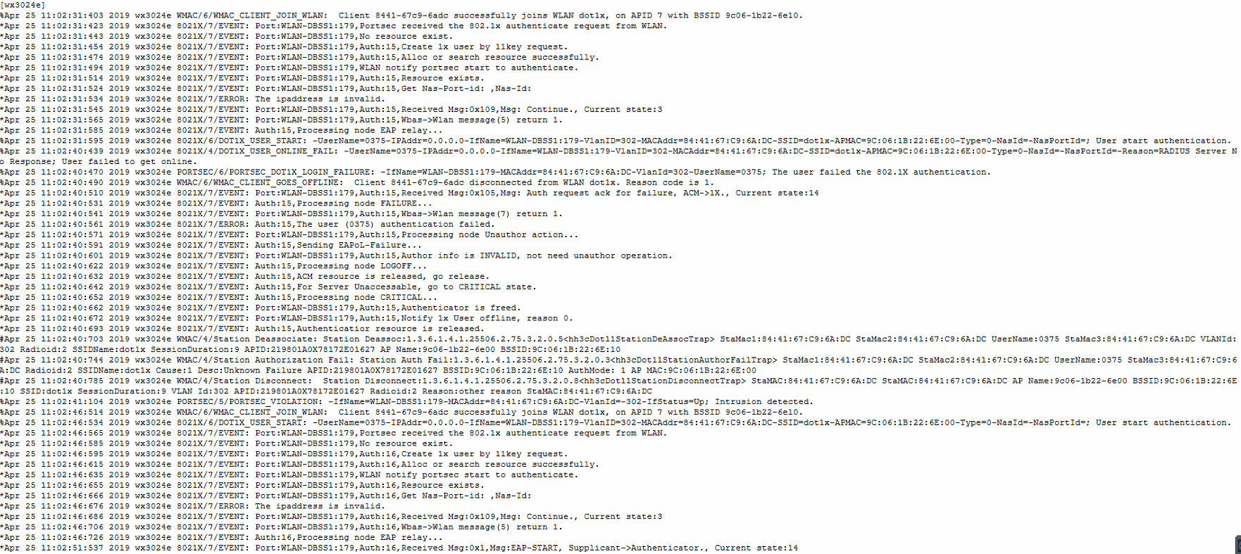

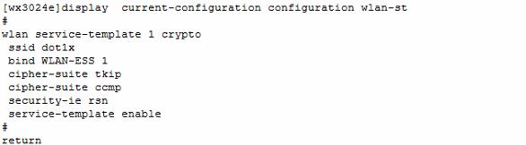

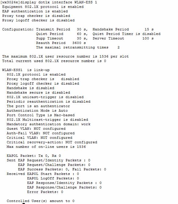

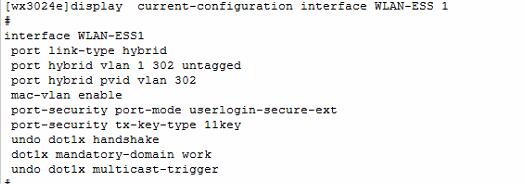

无线侧控制器是WX3024E。用户使用iphone接入,输入用户名和密码后,debug提示各种报错。麻烦帮忙分析下。
%Apr 25 11:02:56:027 2019 wx3024e 8021X/6/DOT1X_USER_START: -UserName=0375-IPAddr=0.0.0.0-IfName=WLAN-DBSS1:179-VlanID=302-MACAddr=84:41:67:C9:6A:DC-SSID=dot1x-APMAC=9C:06:1B:22:6E:00-Type=0-NasId=-NasPortId=; User start authentication.
*Apr 25 11:02:56:057 2019 wx3024e 8021X/7/EVENT: Port:WLAN-DBSS1:179,Auth:17,Get Nas-Port-id: ,Nas-Id:
*Apr 25 11:02:56:068 2019 wx3024e 8021X/7/ERROR: The ipaddress is invalid.
*Apr 25 11:02:56:078 2019 wx3024e 8021X/7/EVENT: Port:WLAN-DBSS1:179,Auth:17,Received Msg:0x109,Msg: Continue., Current state:3
 *Apr 25 11:02:56:098 2019 wx3024e 8021X/7/EVENT: Port:WLAN-DBSS1:179,Auth:17,Wbas->Wlan message(5) return 1.
*Apr 25 11:02:56:118 2019 wx3024e 8021X/7/EVENT: Auth:17,Processing node EAP relay...
%Apr 25 11:02:56:129 2019 wx3024e PORTSEC/5/PORTSEC_VIOLATION: -IfName=WLAN-DBSS1:179-MACAddr=84:41:67:C9:6A:DC-VlanId=-302-IfStatus=Up; Intrusion detected.
*Apr 25 11:03:00:702 2019 wx3024e 8021X/7/EVENT: Port:WLAN-DBSS1:179,Auth:17,Received Msg:0x1,Msg:EAP-START, Supplicant->Authenticator., Current state:14
%Apr 25 11:03:04:689 2019 wx3024e 8021X/4/DOT1X_USER_ONLINE_FAIL: -UserName=0375-IPAddr=0.0.0.0-IfName=WLAN-DBSS1:179-VlanID=302-MACAddr=84:41:67:C9:6A:DC-SSID=dot1x-APMAC=9C:06:1B:22:6E:00-Type=0-NasId=-NasPortId=-Reason=RADIUS Server No Response; User failed to get online.
[wx3024e] %Apr 25 11:03:04:720 2019 wx3024e PORTSEC/6/PORTSEC_DOT1X_LOGIN_FAILURE: -IfName=WLAN-DBSS1:179-MACAddr=84:41:67:C9:6A:DC-VlanId=302-UserName=0375; The user failed the 802.1X authentication.
%Apr 25 11:03:04:740 2019 wx3024e WMAC/6/WMAC_CLIENT_GOES_OFFLINE: Client 8441-67c9-6adc disconnected from WLAN dot1x. Reason code is 1.
*Apr 25 11:03:04:760 2019 wx3024e 8021X/7/EVENT: Port:WLAN-DBSS1:179,Auth:17,Received Msg:0x105,Msg: Auth request ack for failure, ACM->1X., Current state:14
*Apr 25 11:03:04:780 2019 wx3024e 8021X/7/EVENT: Auth:17,Processing node FAILURE...
*Apr 25 11:03:04:791 2019 wx3024e 8021X/7/EVENT: Port:WLAN-DBSS1:179,Auth:17,Wbas->Wlan message(7) return 1.
*Apr 25 11:03:04:811 2019 wx3024e 8021X/7/ERROR: Auth:17,The user (0375) authentication failed.
*Apr 25 11:03:04:821 2019 wx3024e 8021X/7/EVENT: Port:WLAN-DBSS1:179,Auth:17,Processing node Unauthor action...
*Apr 25 11:03:04:841 2019 wx3024e 8021X/7/EVENT: Auth:17,Sending EAPoL-Failure...
*Apr 25 11:03:04:851 2019 wx3024e 8021X/7/EVENT: Port:WLAN-DBSS1:179,Auth:17,Author info is INVALID, not need unauthor operation. *Apr 25 11:03:04:872 2019 wx3024e 8021X/7/EVENT: Auth:17,Processing node LOGOFF...
 [wx3024e] *Apr 25 11:03:04:882 2019 wx3024e 8021X/7/EVENT: Auth:17,ACM resource is released, go release.
*Apr 25 11:03:04:892 2019 wx3024e 8021X/7/EVENT: Auth:17,For Server Unaccessable, go to CRITICAL state.
*Apr 25 11:03:04:902 2019 wx3024e 8021X/7/EVENT: Auth:17,Processing node CRITICAL...
*Apr 25 11:03:04:912 2019 wx3024e 8021X/7/EVENT: Port:WLAN-DBSS1:179,Auth:17,Authenticator is freed.
*Apr 25 11:03:04:922 2019 wx3024e 8021X/7/EVENT: Port:WLAN-DBSS1:179,Auth:17,Notify 1x User offline, reason 0.
 *Apr 25 11:03:04:943 2019 wx3024e 8021X/7/EVENT: Auth:17,Authenticatior resource is released.

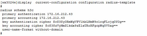

radius scheme h3c视图下需要加一条配置:server-type extended;
是否配置

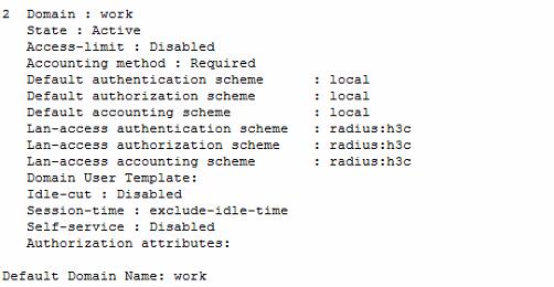

  1. 使能默认域imc
    [AC] domain default enable imc
  2. 以及domain是否配置正确。
%Apr 25 11:03:04:689 2019 wx3024e 8021X/4/DOT1X_USER_ONLINE_FAIL: -UserName=0375-IPAddr=0.0.0.0-IfName=WLAN-DBSS1:179-VlanID=302-MACAddr=84:41:67:C9:6A:DC-SSID=dot1x-APMAC=9C:06:1B:22:6E:00-Type=0-NasId=-NasPortId=-Reason=RADIUS Server No Response; User failed to get online. 从这个日志来看是radius服务器没有回应,是否有AC与radius服务器的抓包,可以排查一下。
池塘边的榕树 发表时间:2019-04-25 更多>>
server-type extended试过了的,看kms上有改成standard成功的案例,才改成了standard模式。 domain是没问题的。使用的是work这个。。。有线也是使用的这个。
zhiliao_CEbbW 发表时间:2019-04-25
