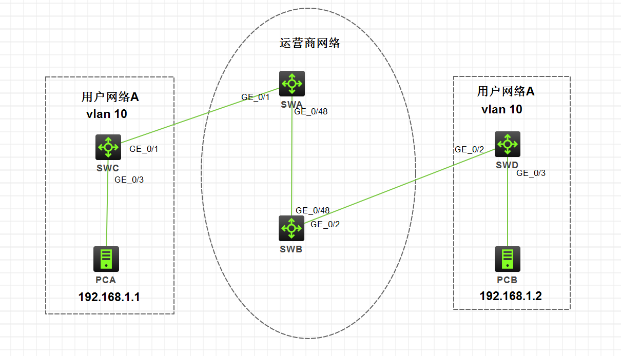

实验组图
配置如下:
配置SWC:
[SWC]vlan 10
[SWC-vlan10]port GigabitEthernet 1/0/3
[SWC-vlan10]quit
[SWC]interface GigabitEthernet 1/0/1
[SWC-GigabitEthernet1/0/1]port link-type trunk
[SWC-GigabitEthernet1/0/1]port trunk permit vlan 10
配置SWD:
[SWD]vlan 10
[SWD-vlan10]port GigabitEthernet 1/0/3
[SWD-vlan10]quit
[SWD]interface GigabitEthernet 1/0/2
[SWD-GigabitEthernet1/0/2]port link-type trunk
[SWD-GigabitEthernet1/0/2]port trunk permit vlan 10
配置SWA:
[SWA]interface GigabitEthernet 1/0/1
[SWA-GigabitEthernet1/0/1]port link-type trunk
[SWA-GigabitEthernet1/0/1]port trunk permit vlan 100 10
[SWA-GigabitEthernet1/0/1]port trunk pvid vlan 100
[SWA-GigabitEthernet1/0/1]qinq enable
[SWA-GigabitEthernet1/0/48]port link-type trunk
[SWA-GigabitEthernet1/0/48]port trunk permit vlan 100
[SWA-GigabitEthernet1/0/48]qinq ethernet-type service-tag 8200
配置SWB:
[SWB]interface GigabitEthernet 1/0/2
[SWB-GigabitEthernet1/0/2]port link-type trunk
[SWB-GigabitEthernet1/0/2]port trunk permit vlan 100 10
[SWB-GigabitEthernet1/0/2]port trunk pvid vlan 100
[SWB-GigabitEthernet1/0/2]qinq enable
[SWB-GigabitEthernet1/0/48]port link-type trunk
[SWB-GigabitEthernet1/0/48]port trunk permit vlan 100
[SWB-GigabitEthernet1/0/48]qinq ethernet-type service-tag 8200
完全按照官方配置实例配置,但是最终还是无法使PCA和PCB互通,不知问题出在哪里?求老师们看看。

您好,根据之前测试及邮件反馈,目前HCL模拟器对QinQ尚不支持
望采纳,谢谢

看着配置应该是没有问题的
看看端口的状态正常吗,有的时候端口会自己down掉的
看过了 端口状态都正常

看着配置没问题
看看端口
hcl的68交换机可以支持qinq 58的我也不通
