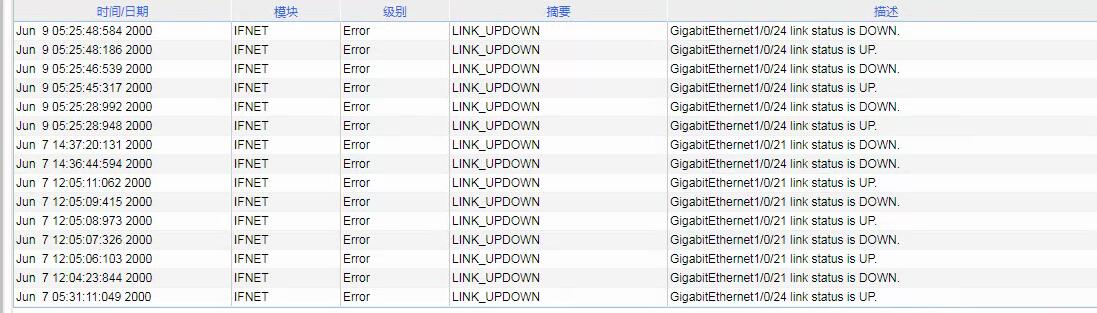

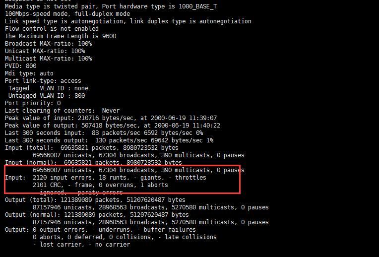

一段时间内 出现大量的错误包 持续半小时
设备型号:S5024PV2-EI
报错如下:
 %May 30 11:31:08:932 2000 H3C IFNET/3/LINK_UPDOWN: GigabitEthernet1/0/22 link status is UP. %May 30 11:31:09:800 2000 H3C IFNET/3/LINK_UPDOWN: GigabitEthernet1/0/22 link status is DOWN. %May 30 11:31:11:448 2000 H3C IFNET/3/LINK_UPDOWN: GigabitEthernet1/0/22 link status is UP. %May 30 14:34:38:073 2000 H3C IFNET/3/LINK_UPDOWN: GigabitEthernet1/0/24 link status is DOWN. %May 30 14:35:15:551 2000 H3C IFNET/3/LINK_UPDOWN: GigabitEthernet1/0/21 link status is DOWN. %May 31 05:27:22:761 2000 H3C IFNET/3/LINK_UPDOWN: GigabitEthernet1/0/21 link status is UP. %May 31 05:27:24:012 2000 H3C IFNET/3/LINK_UPDOWN: GigabitEthernet1/0/21 link status is DOWN. %May 31 05:27:25:645 2000 H3C IFNET/3/LINK_UPDOWN: GigabitEthernet1/0/21 link status is UP. %May 31 05:27:26:055 2000 H3C IFNET/3/LINK_UPDOWN: GigabitEthernet1/0/21 link status is DOWN. %May 31 05:27:27:690 2000 H3C IFNET/3/LINK_UPDOWN: GigabitEthernet1/0/21 link status is UP. %May 31 13:04:58:964 2000 H3C IFNET/3/LINK_UPDOWN: GigabitEthernet1/0/22 link status is DOWN. %May 31 13:05:01:301 2000 H3C IFNET/3/LINK_UPDOWN: GigabitEthernet1/0/22 link status is UP. %May 31 14:03:13:168 2000 H3C IFNET/3/LINK_UPDOWN: GigabitEthernet1/0/22 link status is DOWN. %May 31 14:03:15:507 2000 H3C IFNET/3/LINK_UPDOWN: GigabitEthernet1/0/22 link status is UP. %May 31 14:03:16:314 2000 H3C IFNET/3/LINK_UPDOWN: GigabitEthernet1/0/22 link status is DOWN. %May 31 14:03:18:596 2000 H3C IFNET/3/LINK_UPDOWN: GigabitEthernet1/0/22 link status is UP. %May 31 14:39:52:227 2000 H3C IFNET/3/LINK_UPDOWN: GigabitEthernet1/0/21 link status is DOWN. %May 31 17:39:00:941 2000 H3C IFNET/3/LINK_UPDOWN: GigabitEthernet1/0/3 link status is UP. %May 31 17:39:01:132 2000 H3C IFNET/3/LINK_UPDOWN: GigabitEthernet1/0/3 link status is DOWN.

这种你看看是不是没插紧,然后换个线试一下,crc一般都是线缆问题

目前网线使用的超6类网线,用了1年多了 基本没有问题马今天头一次出现,网线的问题可能性很小。

查看下两端端口的双工和速率是否一致,最好改成自动协商
