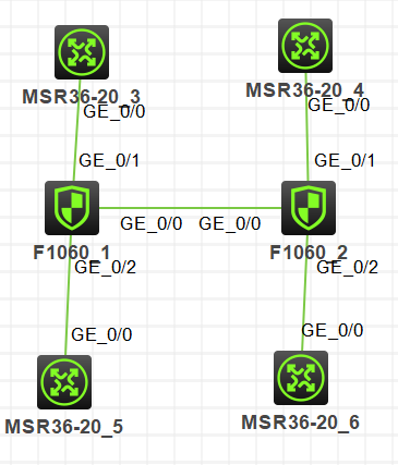

在模拟器新建两台防火墙做堆叠,上下分别用三层链路聚合连接两台路由器。配置了会话同步,策略全放通。接备框的路由器ping接主框的路由器不通,主框没看到会话,会话只存在备框。(没有配置备份组,双主模式)debug aspf,显示The first packet was dropped by ASPF for invalid status
请问这个模拟器问题,还是我缺少什么配置。

来回路径不一致,冗余口冗余组了解一下http://h3c.com/cn/d_201901/1145980_30005_0.htm

路由器跟防火墙没有做跨框链路聚合,怎么会来回路径不一致呢

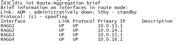

<H3C> <H3C>dis cu # version 7.1.064, Alpha 7164 # sysname H3C # context Admin id 1 # telnet server enable # irf mac-address persistent timer irf auto-update enable undo irf link-delay irf member 1 priority 32 irf member 2 priority 16 # security-zone intra-zone default permit # xbar load-single password-recovery enable lpu-type f-series # vlan 1 # irf-port 1/2 port group interface GigabitEthernet1/0/0 # irf-port 2/1 port group interface GigabitEthernet2/0/0 # interface Route-Aggregation1 ip address 10.0.13.1 255.255.255.0 link-aggregation mode dynamic # interface Route-Aggregation2 ip address 10.0.14.1 255.255.255.0 link-aggregation mode dynamic # interface Route-Aggregation3 ip address 10.0.15.1 255.255.255.0 link-aggregation mode dynamic # interface Route-Aggregation4 ip address 10.0.16.1 255.255.255.0 # interface NULL0 # interface GigabitEthernet1/0/1 port link-mode route combo enable copper ip address 192.168.0.1 255.255.255.0 port link-aggregation group 1 # interface GigabitEthernet1/0/2 port link-mode route combo enable copper port link-aggregation group 3 # interface GigabitEthernet1/0/3 port link-mode route combo enable copper # interface GigabitEthernet1/0/4 port link-mode route combo enable copper # interface GigabitEthernet1/0/5 port link-mode route combo enable copper # interface GigabitEthernet1/0/6 port link-mode route combo enable copper # interface GigabitEthernet1/0/7 port link-mode route combo enable copper # interface GigabitEthernet1/0/8 port link-mode route combo enable copper # interface GigabitEthernet1/0/9 port link-mode route combo enable copper # interface GigabitEthernet1/0/10 port link-mode route combo enable copper # interface GigabitEthernet1/0/11 port link-mode route combo enable copper # interface GigabitEthernet1/0/12 port link-mode route combo enable copper # interface GigabitEthernet1/0/13 port link-mode route combo enable copper # interface GigabitEthernet1/0/14 port link-mode route combo enable copper # interface GigabitEthernet1/0/15 port link-mode route combo enable copper # interface GigabitEthernet1/0/16 port link-mode route combo enable copper # interface GigabitEthernet1/0/17 port link-mode route combo enable copper # interface GigabitEthernet1/0/18 port link-mode route combo enable copper # interface GigabitEthernet1/0/19 port link-mode route combo enable copper # interface GigabitEthernet1/0/20 port link-mode route combo enable copper # interface GigabitEthernet1/0/21 port link-mode route combo enable copper # interface GigabitEthernet1/0/22 port link-mode route combo enable copper # interface GigabitEthernet1/0/23 port link-mode route combo enable copper # interface GigabitEthernet2/0/1 port link-mode route combo enable copper port link-aggregation group 2 # interface GigabitEthernet2/0/2 port link-mode route combo enable copper port link-aggregation group 4 # interface GigabitEthernet2/0/3 port link-mode route combo enable copper # interface GigabitEthernet2/0/4 port link-mode route combo enable copper # interface GigabitEthernet2/0/5 port link-mode route combo enable copper # interface GigabitEthernet2/0/6 port link-mode route combo enable copper # interface GigabitEthernet2/0/7 port link-mode route combo enable copper # interface GigabitEthernet2/0/8 port link-mode route combo enable copper # interface GigabitEthernet2/0/9 port link-mode route combo enable copper # interface GigabitEthernet2/0/10 port link-mode route combo enable copper # interface GigabitEthernet2/0/11 port link-mode route combo enable copper # interface GigabitEthernet2/0/12 port link-mode route combo enable copper # interface GigabitEthernet2/0/13 port link-mode route combo enable copper # interface GigabitEthernet2/0/14 port link-mode route combo enable copper # interface GigabitEthernet2/0/15 port link-mode route combo enable copper # interface GigabitEthernet2/0/16 port link-mode route combo enable copper # interface GigabitEthernet2/0/17 port link-mode route combo enable copper # interface GigabitEthernet2/0/18 port link-mode route combo enable copper # interface GigabitEthernet2/0/19 port link-mode route combo enable copper # interface GigabitEthernet2/0/20 port link-mode route combo enable copper # interface GigabitEthernet2/0/21 port link-mode route combo enable copper # interface GigabitEthernet2/0/22 port link-mode route combo enable copper # interface GigabitEthernet2/0/23 port link-mode route combo enable copper # interface GigabitEthernet1/0/0 combo enable copper # interface GigabitEthernet2/0/0 combo enable fiber # security-zone name Local # security-zone name Trust import interface Route-Aggregation3 import interface Route-Aggregation4 # security-zone name DMZ # security-zone name Untrust import interface Route-Aggregation1 import interface Route-Aggregation2 # security-zone name Management # scheduler logfile size 16 # line class aux user-role network-operator # line class console user-role network-admin # line class tty user-role network-operator # line class vty user-role network-operator # line aux 0 user-role network-admin # line aux 1 user-role network-operator # line con 0 1 authentication-mode scheme user-role network-admin # line vty 0 4 authentication-mode scheme user-role network-admin # line vty 5 63 user-role network-operator # domain system # aaa session-limit ftp 16 aaa session-limit telnet 16 aaa session-limit ssh 16 domain default enable system # role name level-0 description Predefined level-0 role # role name level-1 description Predefined level-1 role # role name level-2 description Predefined level-2 role # role name level-3 description Predefined level-3 role # role name level-4 description Predefined level-4 role # role name level-5 description Predefined level-5 role # role name level-6 description Predefined level-6 role # role name level-7 description Predefined level-7 role # role name level-8 description Predefined level-8 role # role name level-9 description Predefined level-9 role # role name level-10 description Predefined level-10 role # role name level-11 description Predefined level-11 role # role name level-12 description Predefined level-12 role # role name level-13 description Predefined level-13 role # role name level-14 description Predefined level-14 role # user-group system # local-user admin class manage password hash $h$6$UbIhNnPevyKUwfpm$LqR3+yg1IjNct39MkOR0H0iQXLkYB3jMqM4vbAeoXOhbabIIFnjJPEGR00YiYA1Sz4LiY3FmEdru2fOLMb1shQ== service-type telnet terminal http authorization-attribute user-role level-3 authorization-attribute user-role network-admin authorization-attribute user-role network-operator # session statistics enable session synchronization enable session synchronization dns http # ip http enable ip https enable # security-policy ip rule 0 name any action pass # return
