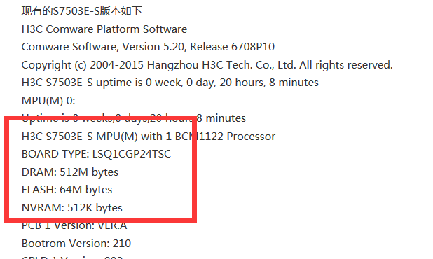

请问我现在的S7503E-S是v5.2的固件,能升级成最新的V7的固件吗?如果能升级请问如何升级(S7500E-CMW710-R7585的压缩包里面有很多文件,而且容量有八百多字,我的7503只有64M的FLASH,具体是用哪个文件进行升级呢?)
现有的S7503E-S版本如下
H3C Comware Platform Software
Comware Software, Version 5.20, Release 6708P10
Copyright (c) 2004-2015 Hangzhou H3C Tech. Co., Ltd. All rights reserved.
H3C S7503E-S uptime is 0 week, 0 day, 20 hours, 8 minutes
MPU(M) 0:
Uptime is 0 weeks,0 days,20 hours,8 minutes
H3C S7503E-S MPU(M) with 1 BCM1122 Processor
BOARD TYPE: LSQ1CGP24TSC
DRAM: 512M bytes
FLASH: 64M bytes
NVRAM: 512K bytes
PCB 1 Version: VER.A
Bootrom Version: 210
CPLD 1 Version: 002
CPLD 2 Version: 002
Release Version: H3C S7503E-S-6708P10
Patch Version : None
 Slot 1 Without Board
 Slot 2 Without Board

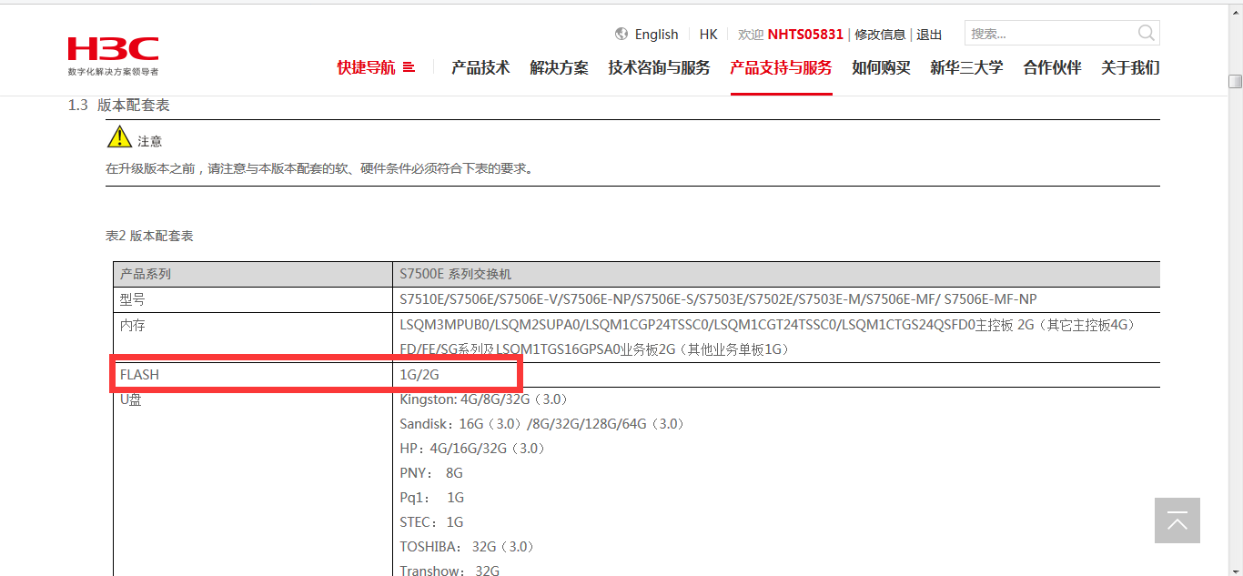

很遗憾,您现场的不支持升级到该版本,其他的我还没仔细看,就单单flash空间这一条就不支持了,版本要求:
现场:
