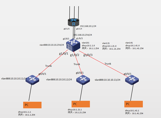

客户机都够正常上网,但是不能够访问其他网段的客户机,
ping测试结果:客户机ping自己的网关可以通信,ping 对方的网关地址也可以通信
故障:接入层PC之间不能相互访问

看看对方终端有没有开防火墙,最好把交换机配置发上来看看

配置: 核心(三层转发): dhcp enable dhcp server forbidden-ip 10.1.1.1 10.1.1.110 dhcp server forbidden-ip 10.1.21.1 10.1.21.110 dhcp server forbidden-ip 10.1.41.1 10.1.41.110 # dhcp server ip-pool vlan101 gateway-list 10.1.1.254 network 10.1.1.0 mask 255.255.255.0 dns-list 222.74.1.200 114.114.114.114 # dhcp server ip-pool vlan121 gateway-list 10.1.21.254 network 10.1.21.0 mask 255.255.255.0 dns-list 222.74.1.200 114.114.114.114 # dhcp server ip-pool vlan141 gateway-list 10.1.41.254 network 10.1.41.0 mask 255.255.255.0 dns-list 222.74.1.200 114.114.114.114 # interface Bridge-Aggregation1 #(聚合接口地址) interface Route-Aggregation1 ip address 192.168.10.254 255.255.255.0 # interface Vlan-interface101 ip address 10.1.1.254 255.255.255.0 # interface Vlan-interface121 ip address 10.1.21.254 255.255.255.0 # interface Vlan-interface141 ip address 10.1.41.254 255.255.255.0 # interface GigabitEthernet1/0/1 port link-mode bridge description TO-1-SW1 port link-type trunk port trunk permit vlan all # interface GigabitEthernet1/0/2 port link-mode bridge description TO-1-SW2 port link-type trunk port trunk permit vlan all port trunk pvid vlan 888 # interface GigabitEthernet1/0/3 port link-mode bridge description TO-1-SW3 port link-type trunk port trunk permit vlan all # ip route-static 0.0.0.0 0 192.168.10.1 汇聚: # vlan batch 101 to 119 121 888 # vlan 888 description guanli # interface Vlanif888 ip address 10.10.10.11 255.255.255.0 # interface GigabitEthernet0/0/1 port link-type trunk port trunk allow-pass vlan 2 to 4094 # interface Ethernet0/0/1 port link-type access port default vlan 101 # ip route-static 0.0.0.0 0.0.0.0 10.10.10.254 #

同一网段可以互访,往下边的不能互访

把所有trunk口都改成 port trunk permit all 试试

华三核心交换机: arp 静态mac 动态mac 板卡1: 24电口 16k 4k 20k 板卡2:48光口 8k 4k 20k 华为汇聚交换机: 16k 现象:终端互通不稳定,之前的终端设备可以互访,之后加入的不能互通,在核心上刷新 dhcp地址池,和arp缓存之后,原来的能互通的现在有些不通了 原来不能互通的 现在有一些又可以互通了。 分析:1、 终端设备数量将近5万台,经过核实,核心上arp表项只能容纳8K,而且所有地址池和各个网段的网关都设置在核心上,由核心进行数据转发,会不会arp过载,影响数据的转发,导致终端与终端之间不能够互访

交换机就是三层设备,ping没问题,理论上互访就应该没问题,是否有设备做了控制策略

没有做任何的策略,配置也没有问题

不会吧,如果pingp对方网关通的话,下面电脑也应该通的,需要远程的话,加我扣扣给你看看
