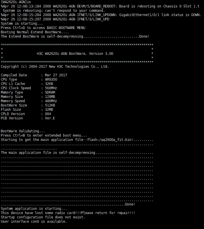

        上午发了一个,没解释清楚,该AP型号为WA2620i-AGN,模式为fit, AC控制,之前一直正常使用,昨天突然掉线,连接不上AC,获取不到地址,设备一直红灯闪烁。先排除了网线问题,后来电脑连接启动日志如下:
BootWare Validating... Press Ctrl+B to enter extended boot menu... Starting to get the main application file--flash:/wa2600a_fit.bin!.......... ............................................................................ ............................ The main application file is self-decompressing............................. ............................................................................ ............................................................................ ............................................................................ ............................................................................ ............................................................................ ............................................................................ ............................................................................ ............................................................................ ............................................................................ ............................................................................ ............................................................................ ..............................................................Done! System application is starting... This device have lost some radio card!!!Please return for repair!!! Startup configuration file does not exist. User interface con0 is available.
翻译意思应该是什么丢失,请返修,该设备刚刚过了保修期了,我自己刷了下固件,还是报这个错误。

应该是射频硬件故障了,只能返修
