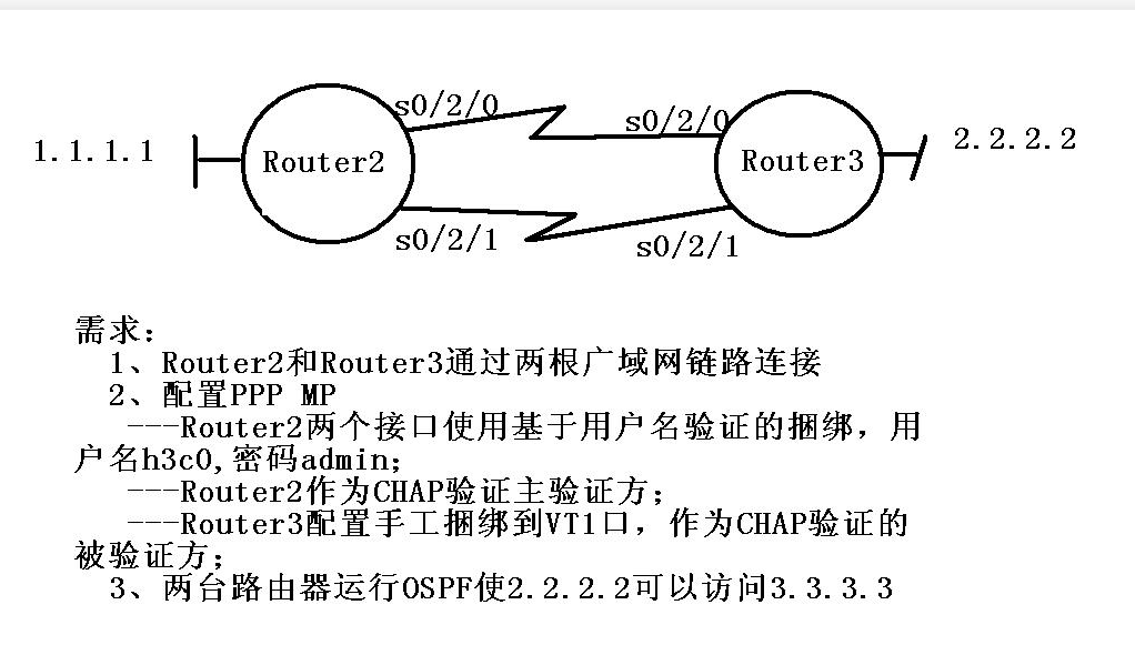

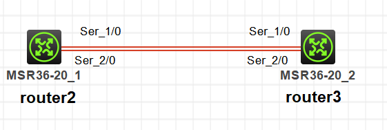

router2和router3上的S1/0和S2/0接口配置相同。配置完后
%Aug 12 10:42:22:382 2019 router3 IFNET/3/PHY_UPDOWN: Physical state on the interface Serial1/0 changed to down. %Aug 12 10:42:22:389 2019 router3 IFNET/3/PHY_UPDOWN: Physical state on the interface Serial1/0 changed to up.
然后接口一直处于DOWN状态
