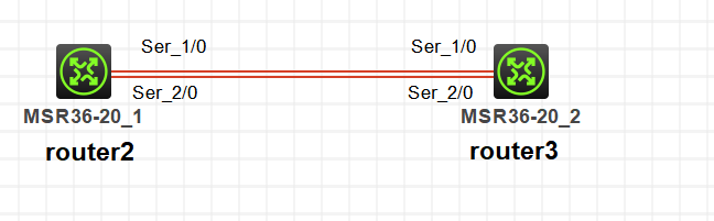

[router2] ppp mp user h3c0 bind Virtual-Template 1
[router2-Virtual-Template1]dis this
# interface Virtual-Template1
 ppp mp binding-mode authentication
 ip address 1.1.1.1 255.255.255.252
[router2-Serial1/0]dis this
# interface Serial1/0
 ppp authentication-mode chap
 ppp mp #
[router2]local-user h3c0 class network
 [router2-luser-network-h3c0]service-type ppp
 [router2-luser-network-h3c0]password simple 123
[router3]int s1/0
 [router3-Serial1/0]ppp authentication-mode chap
router3-Serial1/0]ppp chap user h3c0
[router3-Serial1/0]ppp chap password simple 123
[router3-Serial1/0]ppp mp Virtual-Template 1
router2和router3上的S1/0和S2/0接口配置相同。配置完后
%Aug 12 10:42:22:382 2019 router3 IFNET/3/PHY_UPDOWN: Physical state on the interface Serial1/0 changed to down. %Aug 12 10:42:22:389 2019 router3 IFNET/3/PHY_UPDOWN: Physical state on the interface Serial1/0 changed to up.
然后接口一直处于DOWN状态
我这边没问题,再检查一下配置吧
