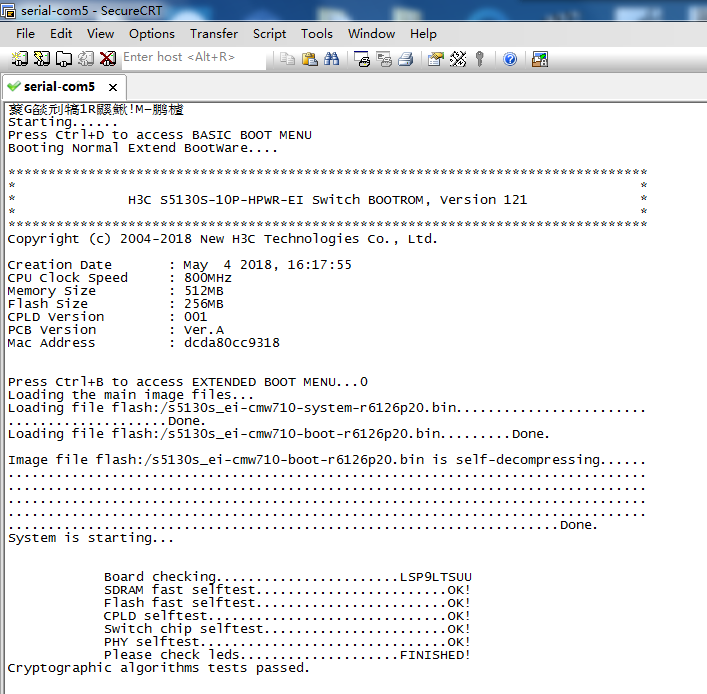

S5130S-10P-HPWR-EI,这款交换机,通过超级终端/CRT连接后,无法配置;开机进系统界面正常,如下:
******************************************************************************** * * * H3C S5130S-10P-HPWR-EI Switch BOOTROM, Version 121 * * * ******************************************************************************** Copyright (c) 2004-2018 New H3C Technologies Co., Ltd. Creation Date : May 4 2018, 16:17:55 CPU Clock Speed : 800MHz Memory Size : 512MB Flash Size : 256MB CPLD Version : 001 PCB Version : Ver.A Mac Address : dcda80cc9318 Press Ctrl+B to access EXTENDED BOOT MENU...0 Loading the main image files... Loading file flash:/s5130s_ei-cmw710-system-r6126p20.bin........................ ....................Done. Loading file flash:/s5130s_ei-cmw710-boot-r6126p20.bin.........Done. Image file flash:/s5130s_ei-cmw710-boot-r6126p20.bin is self-decompressing...... ................................................................................ ................................................................................ ................................................................................ ................................................................................ .....................................................................Done. System is starting... Board checking.......................LSP9LTSUU SDRAM fast selftest........................OK! Flash fast selftest........................OK! CPLD selftest..............................OK! Switch chip selftest.......................OK! PHY selftest...............................OK! Please check leds....................FINISHED! Cryptographic algorithms tests passed. Startup configuration file doesn't exist or is invalid. Performing automatic configuration... Press CTRL_C or CTRL_D to break. Automatic configuration attempt: 1. Not ready for automatic configuration: no interface available. Waiting for the next... Automatic configuration attempt: 2. Not ready for automatic configuration: no interface available. Waiting for the next... Automatic configuration attempt: 3. Not ready for automatic configuration: no interface available. Waiting for the next... Automatic configuration attempt: 4. Not ready for automatic configuration: no interface available. Waiting for the next... Automatic configuration attempt: 5. Not ready for automatic configuration: no interface available. Waiting for the next... Automatic configuration attempt: 6. Not ready for automatic configuration: no interface available. Waiting for the next... Automatic configuration attempt: 7. Not ready for automatic configuration: no interface available. Waiting for the next...

设备第一次上电,空配置启动时,
需要按ctrl +D 跳过

解决了。。。。
在版权检测通过后
会提示按回车,终端下面的检测,然后就可以直接进入系统,这时候按回车,然后提示按ctrl+C/D,就可中断,然后按回车就进去了。。。。
很奇怪,第一次怎么都进不去,后面就能进去了。。。。

设备第一次上电,空配置启动时,
需要按ctrl +D或者Ctrl C 中断,然后按回车进入,如果出现配置不了的情况,请更换台式机进行配置
以后遇到这种问题,
①关闭crt分流
②更换console线
这两个方法必解决
