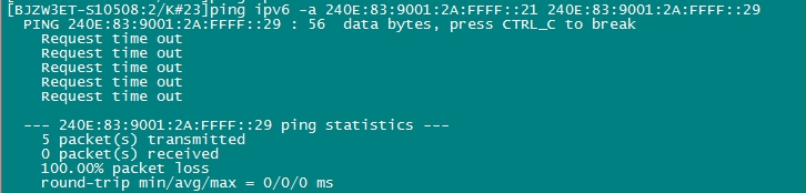

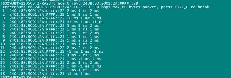

S10508上无法ping通客户的业务地址,查看路由发现存在路由环路

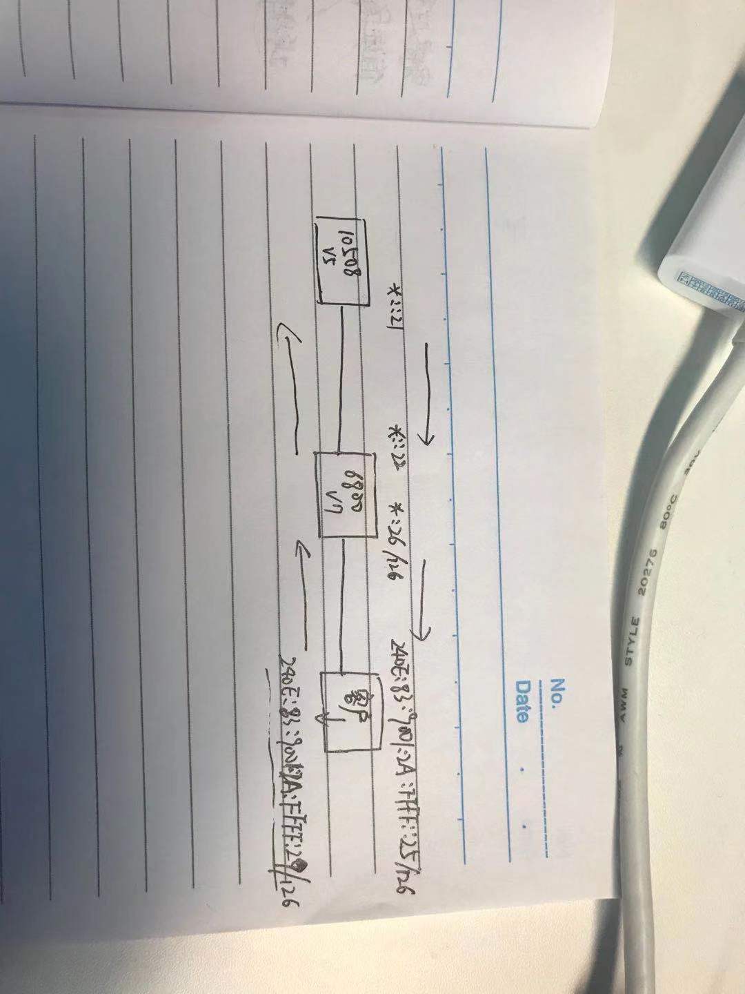

 网络拓扑结构如下图所示,*代表240E:83:9001:2A:FFFF网段
S10508 V5版本的配置如下:#
interface Vlan-interface4020
 description D_BJZW3ET-S6800X2:1_Svi4020_IPv6
 ipv6 address 240E:83:9001:2A:FFFF::21/126
#ipv6 route-static 240E:83:9001:2A:FFFF::28 126 Vlan-interface4020 240E:83:9001:2A:FFFF::22#
interface Bridge-Aggregation15
 description D_BJZW3ET-S6800X2:1_Bri15
 port link-type trunk
 undo port trunk permit vlan 1
 port trunk permit vlan 114 to 115 4020
#S6800 V7版本的配置如下#
 description D_BJZW3ET-S10508:1_Svi4020_IPv6
 ipv6 address 240E:83:9001:2A:FFFF::22/126
interface Vlan-interface1901
 description test-ipv6
 ipv6 address 240E:83:9001:2A:FFFF::26/126
 description D_BJZW3ET-S10508:2_Bri15
ipv6 route-static 240E:83:9001:2A:FFFF::28 126 Vlan-interface1901 240E:83:9001:2A:FFFF::25ipv6 route-static :: 0 Vlan-interface4020 240E:83:9001:2A:FFFF::21#

去往29的流量,105上根据静态路由发给68
68上根据静态路由发给105 ,你的路由就是这么配置,29在哪里,可以在68上再写一条静态
s6800上有关于29的路由

静态路由形成的环路?
那再配置明细路由指向正确的出口试试呢。
Kylin 发表时间:2019-10-30 更多>>
是的,从10508发过来ping包,在6800上感觉明细路由不存在,走默认路由回来了
风巡1990 发表时间:2019-10-30
那再配置明细路由指向正确的出口试试呢。
