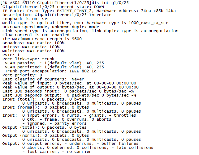

h3c s5110-28p-pwr交换机光模块插到25号口,光纤也插上了,只是灯不亮,查看状态,显示如下:
请问该怎么办

对端是什么设备的什么接口?
对端也是S5110-28P-PWR ,接的25号接口,插的光模块

光模块是1310的还是850的?两端光模块是否一致?单纤还是双纤?传输距离有多远?
回复zhiliao_CR:
[JK-AS02-S5110]display transceiver alarm interface GigabitEthernet1/0/25 GigabitEthernet1/0/25 transceiver current alarm information: RX power low RX signal loss [JK-AS02-S5110]display transceiver diagnosis interface GigabitEthernet1/0/25 GigabitEthernet1/0/25 transceiver diagnostic information: Current diagnostic parameters: Temp.( Voltage(V) Bias(mA) RX power(dBm) TX power(dBm) 24 3.37 19.11 -40.00 -5.68 [JK-AS02-S5110]display transceiver manuinfo interface GigabitEthernet 1/0/25 GigabitEthernet1/0/25 transceiver manufacture information: Manu. Serial Number : 210231A563X09A006893 Manufacturing Date : 2010-01-22 Vendor Name : H3C
zhiliao_eE4At4 发表时间:2019-12-30 更多>>
1310,单纤,sc口,200米的光纤
display transceiver alarm interface GigabitEthernet1/0/25 display transceiver diagnosis interface GigabitEthernet1/0/25 display transceiver manuinfo interface GigabitEthernet 1/0/25 这三项命令输一下然后反馈一下输出的结果
zhiliao_CR 发表时间:2019-12-30

回复zhiliao_CR:
