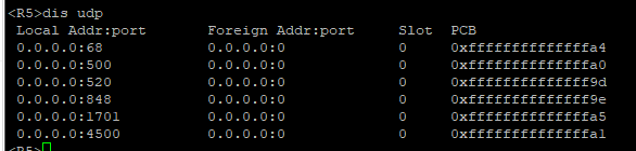

如何查看防火墙udp500是否开启,还有我debug IKE的时候,
*Apr 15 12:05:00:719 2020 分部 IKE/7/EVENT: Received message from ipsec, message type is 8. %Apr 15 12:05:00:725 2020 分部 IFNET/5/LINK_UPDOWN: Line protocol state on the interface Dialer1 changed to up. *Apr 15 12:05:00:755 2020 分部 IKE/7/EVENT: Received message from ipsec, message type is 8.
这个是不是从代表从对面获取ike,我这2边都是拨号上网,做IPSec vpn

代表收到协商报文,dis udp 查看端口监听

代表收到了对面发过来的ike协商报文
