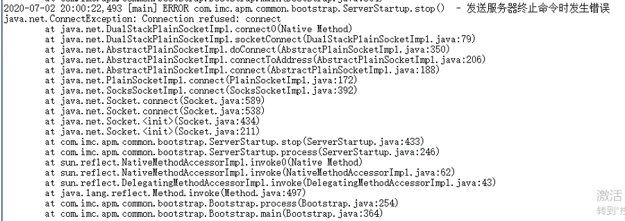

apmserver 无法启动,查看日志,报如下错误:2020-07-02 20:00:22,493 [main] ERROR com.imc.apm.common.bootstrap.ServerStartup.stop() - 发送服务器终止命令时发生错误 java.net.ConnectException: Connection refused: connect at java.net.DualStackPlainSocketImpl.connect0(Native Method) at java.net.DualStackPlainSocketImpl.socketConnect(DualStackPlainSocketImpl.java:79) at java.net.AbstractPlainSocketImpl.doConnect(AbstractPlainSocketImpl.java:350) at java.net.AbstractPlainSocketImpl.connectToAddress(AbstractPlainSocketImpl.java:206) at java.net.AbstractPlainSocketImpl.connect(AbstractPlainSocketImpl.java:188) at java.net.PlainSocketImpl.connect(PlainSocketImpl.java:172) at java.net.SocksSocketImpl.connect(SocksSocketImpl.java:392) at java.net.Socket.connect(Socket.java:589) at java.net.Socket.connect(Socket.java:538) at java.net.Socket.(Socket.java:434) at java.net.Socket.(Socket.java:211) at com.imc.apm.common.bootstrap.ServerStartup.stop(ServerStartup.java:433) at com.imc.apm.common.bootstrap.ServerStartup.process(ServerStartup.java:246) at sun.reflect.NativeMethodAccessorImpl.invoke0(Native Method) at sun.reflect.NativeMethodAccessorImpl.invoke(NativeMethodAccessorImpl.java:62) at sun.reflect.DelegatingMethodAccessorImpl.invoke(DelegatingMethodAccessorImpl.java:43) at java.lang.reflect.Method.invoke(Method.java:497) at com.imc.apm.common.bootstrap.Bootstrap.process(Bootstrap.java:254) at com.imc.apm.common.bootstrap.Bootstrap.main(Bootstrap.java:364)

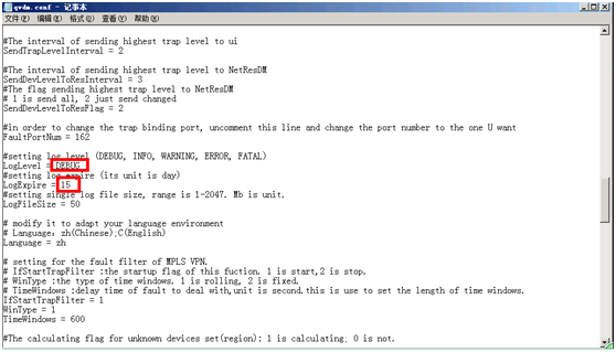

另外在iMC\server\conf\下找到qvdm.conf这个文件打开,修改日志级别为debug如下图:
修改完成后,再重启apmserver进程。同时收集如下日志反馈400定位:
