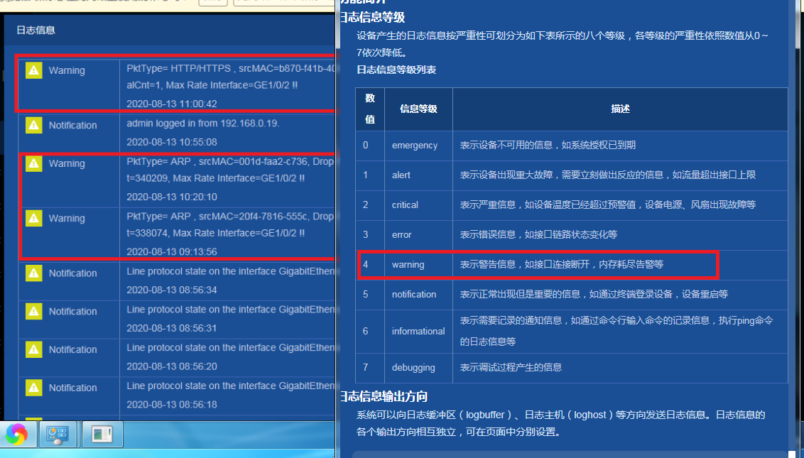

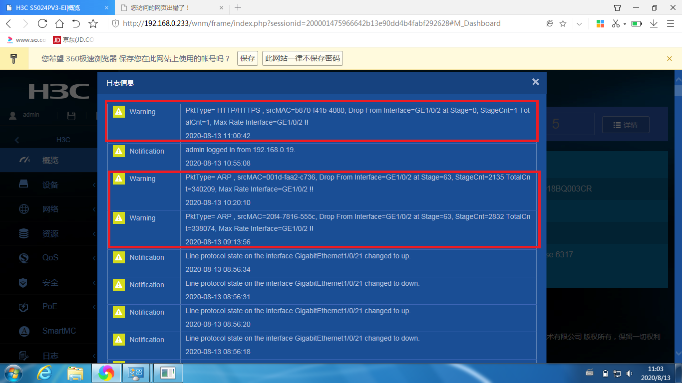

机房停过一次电以后 就开始报错了 0\2接口是三层下来的线 请问报错的是什么意思

对应接口每秒上送的CPU超接口默认阈值被丢弃了,查下对应接口下联终端是否存在攻击等情况
查了的 对应的终端没有任何问题
zhiliao_5DbL9 发表时间:2020-08-13 更多>>
查了的 对应的终端没有任何问题

2020-08-13 16:16:24Warning
PktType= ARP , srcMAC=001d-faa2-c736, Drop From Interface=GE1/0/2 at Stage=63, StageCnt=4722 TotalCnt=354082, Max Rate Interface=GE1/0/2 !!
2020-08-13 15:40:22Warning
PktType= ARP , srcMAC=aee2-4860-3042, Drop From Interface=GE1/0/2 at Stage=63, StageCnt=3497 TotalCnt=349360, Max Rate Interface=GE1/0/2 !!
2020-08-13 14:33:39Warning
PktType= ARP , srcMAC=9487-e01a-34da, Drop From Interface=GE1/0/2 at Stage=63, StageCnt=2265 TotalCnt=345863, Max Rate Interface=GE1/0/2 !!
2020-08-13 13:27:44Notification
admin logged out from 192.168.0.20.
2020-08-13 13:17:40Warning
PktType= HTTP/HTTPS , srcMAC=0023-2484-f8b6, Drop From Interface=GE1/0/2 at Stage=0, StageCnt=30 TotalCnt=31, Max Rate Interface=GE1/0/2 !!
2020-08-13 13:06:54Notification
admin logged in from 192.168.0.20.
2020-08-13 13:06:50Warning
PktType= ARP , srcMAC=9487-e01a-34da, Drop From Interface=GE1/0/2 at Stage=63, StageCnt=2308 TotalCnt=343598, Max Rate Interface=GE1/0/2 !!
2020-08-13 12:26:33Warning
PktType= ARP , srcMAC=001d-faa2-c736, Drop From Interface=GE1/0/2 at Stage=63, StageCnt=1081 TotalCnt=341290, Max Rate Interface=GE1/0/2 !!
2020-08-13 11:25:00Notification
admin logged out from 192.168.0.19.
2020-08-13 11:17:08Warning
PktType= HTTP/HTTPS , srcMAC=b870-f41b-4080, Drop From Interface=GE1/0/2 at Stage=0, StageCnt=1 TotalCnt=1, Max Rate Interface=GE1/0/2 !!
2020-08-13 11:00:42Notification
admin logged in from 192.168.0.19.
2020-08-13 10:55:08Warning
PktType= ARP , srcMAC=001d-faa2-c736, Drop From Interface=GE1/0/2 at Stage=63, StageCnt=2135 TotalCnt=340209, Max Rate Interface=GE1/0/2 !!
2020-08-13 10:20:10Warning
PktType= ARP , srcMAC=20f4-7816-555c, Drop From Interface=GE1/0/2 at Stage=63, StageCnt=2832 TotalCnt=338074, Max Rate Interface=GE1/0/2 !!
2020-08-13 09:13:56Notification
Line protocol state on the interface GigabitEthernet1/0/21 changed to up.
2020-08-13 08:56:34Notification
Line protocol state on the interface GigabitEthernet1/0/21 changed to down.
2020-08-13 08:56:31Notification
2020-08-13 08:56:20Notification
2020-08-13 08:56:18Warning
PktType= ARP , srcMAC=0023-2484-f8b6, Drop From Interface=GE1/0/2 at Stage=63, StageCnt=647 TotalCnt=335242, Max Rate Interface=GE1/0/2 !!
