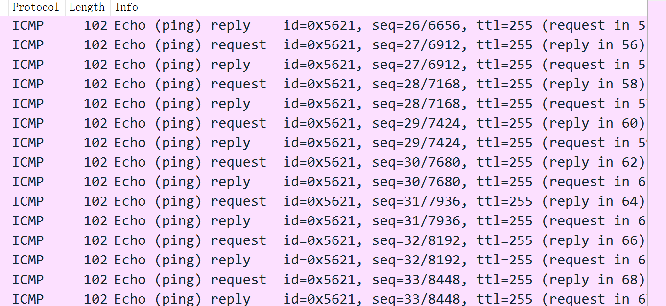

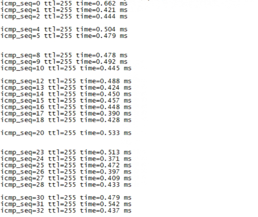

让现场写ACLweb页面抓包,然后ping测试
测试Ping34个包,命令行上显示有丢包,但是抓包文件里34个包有发有收

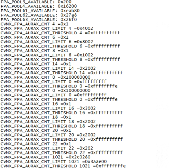

查看驱动丢包和单核cpu使用情况:
dis process cpu slot 1 | in kdr
       486 0.0% 0.0% 0.0% [kdrvBoardTsk0]
       487 0.0% 0.0% 0.0% [kdrvdp0]
       488 0.0% 0.0% 0.0% [kdrvdp1]
       489 0.0% 0.0% 0.0% [kdrvdp2]
       490 0.0% 0.0% 0.0% [kdrvdp3]
       491 0.0% 0.0% 0.0% [kdrvdp4]
       492 0.0% 0.0% 0.0% [kdrvdp5]
       493 0.0% 0.0% 0.0% [kdrvdp6]
       494 0.0% 0.0% 0.0% [kdrvdp7]
       495 0.0% 0.0% 0.0% [kdrvdp8]
       496 0.0% 0.0% 0.0% [kdrvdp9]
       497 0.0% 0.0% 0.0% [kdrvdp10]
       498 0.0% 0.0% 0.0% [kdrvdp11]
       499 0.0% 0.0% 0.0% [kdrvdp12]
       500 0.0% 0.0% 0.0% [kdrvdp13]
       501 0.0% 0.0% 0.0% [kdrvdp14]
       502 0.0% 0.0% 0.0% [kdrvdp15]
       503 0.0% 0.0% 0.0% [kdrvdp16]
       504 0.0% 0.0% 0.0% [kdrvdp17]
       505 0.0% 0.0% 0.0% [kdrvdp18]
       506 0.0% 0.0% 0.0% [kdrvdp19]
       507 0.0% 0.0% 0.0% [kdrvdp20]
       508 0.0% 0.0% 0.0% [kdrvdp21]
       509 0.0% 0.0% 0.0% [kdrvdp22]
       510 0.0% 0.0% 0.0% [kdrvdp23]
       511 0.0% 0.0% 0.0% [kdrvdp24]
       512 0.0% 0.0% 0.0% [kdrvdp25]
       513 0.0% 0.0% 0.0% [kdrvdp26]
       514 0.0% 0.0% 0.0% [kdrvdp27]
       515 0.0% 0.0% 0.0% [kdrvdp28]
       516 0.0% 0.0% 0.0% [kdrvdp29]
       517 0.0% 0.0% 0.0% [kdrvdp30]
       518 0.0% 0.0% 0.0% [kdrvdp31]
       519 0.0% 0.0% 0.0% [kdrvdp32]
       520 0.0% 0.0% 0.0% [kdrvdp33]
       521 0.0% 0.0% 0.0% [kdrvdp34]
       522 0.0% 0.0% 0.0% [kdrvdp35]
       523 0.0% 0.0% 0.0% [kdrvdp36]
       524 0.0% 0.0% 0.0% [kdrvdp37]
       525 0.0% 0.0% 0.0% [kdrvdp38]
       526 0.0% 0.0% 0.0% [kdrvdp39]
       527 0.0% 0.0% 0.0% [kdrvdp40]
       528 0.0% 0.0% 0.0% [kdrvdp41]
       529 0.0% 0.0% 0.0% [kdrvdp42]
       530 0.0% 0.0% 0.0% [kdrvdp43]
       531 0.0% 0.0% 0.0% [kdrvdp44]
       532 0.0% 0.0% 0.0% [kdrvdp45]
       533 0.0% 0.0% 0.0% [kdrvdp46]
       534 0.0% 0.0% 0.0% [kdrvdp47]
       535 0.0% 0.0% 0.0% [kdrvDataSync0]
       542 0.0% 0.0% 0.0% [kdrvtxtemp0]
       544 0.0% 0.0% 0.0% [kdrvlink0]
