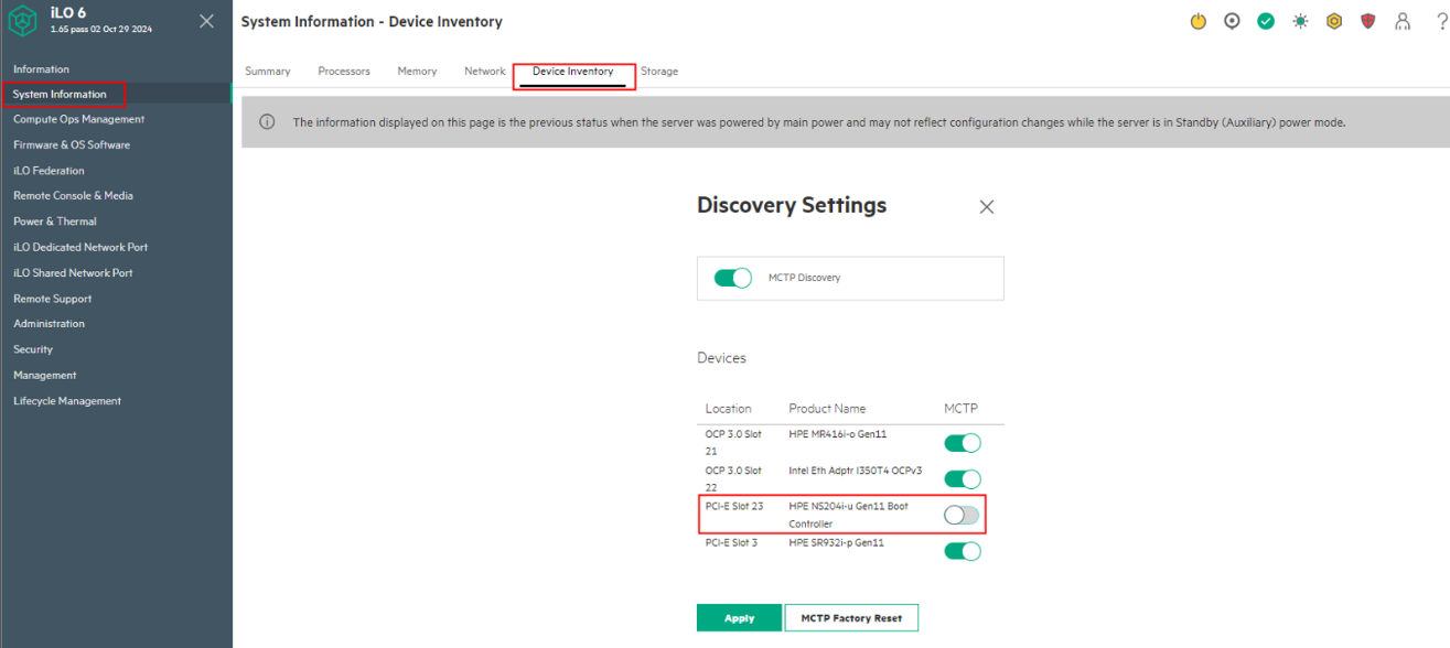

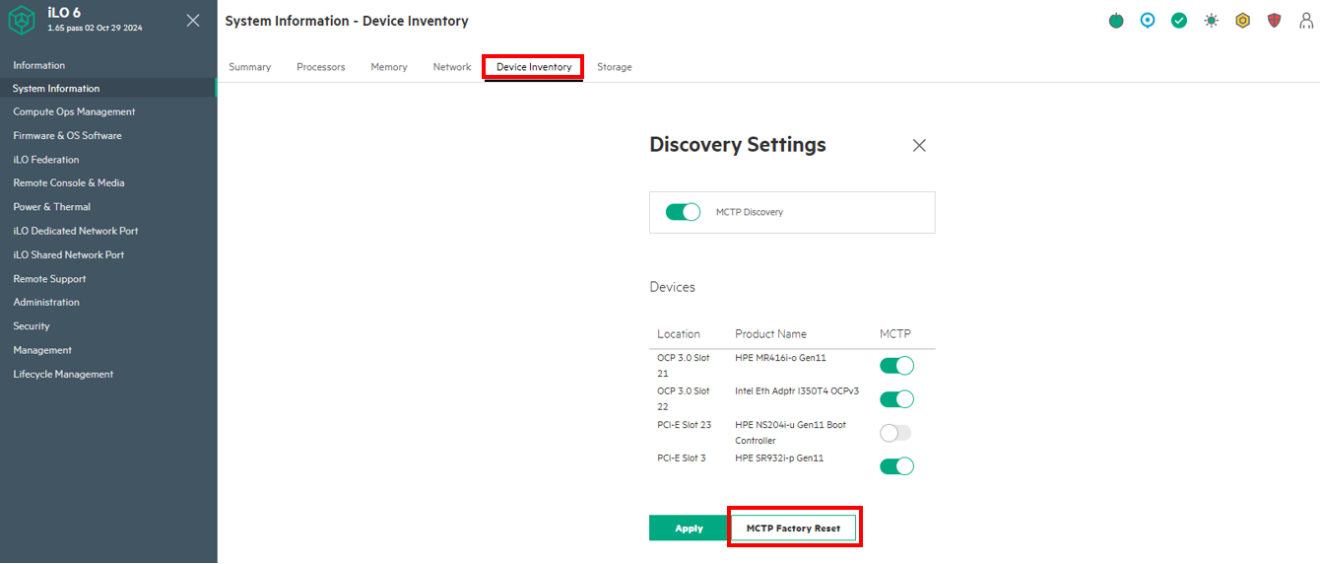

1. ILO GUI禁用NS204i-u MCTP

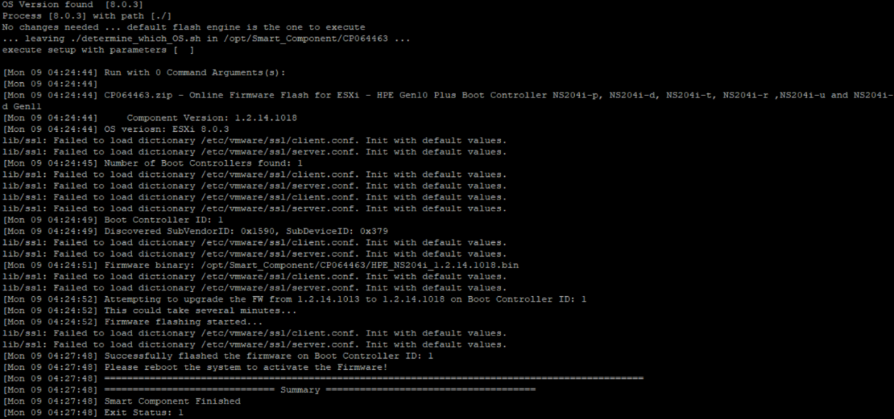

2. 下载如下固件进行更新
  • Windows:
https://downloads.hpe.com/pub/softlib2/software1/sc-windows-fw/p79907742/v258680/cp064461.exe
  • Linux:
https://downloads.hpe.com/pub/softlib2/software1/sc-linux-fw/p1161609642/v258681/rpm/RPMS/x86_64/firmware-9041739931-1.2.14.1018-1.1.x86_64.rpm
  • ESXi:
https://downloads.hpe.com/pub/softlib2/software1/sc-linux-fw/p1705244753/v258682/CP064463.zip
注意:如果第一次刷新失败,请重新启动系统并再次刷新组件。
注意:警告消息"Failed to load dictionary /etc/vmware/ssl/xxxxxx.conf. Init with default values" 不会影响固件升级结果,可以安全忽略。

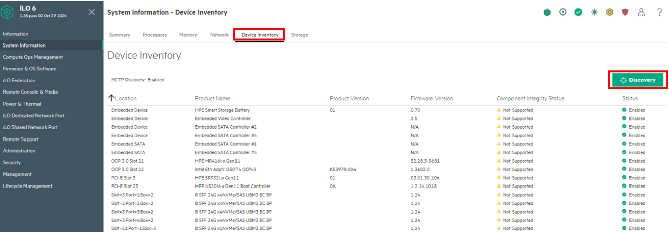

3. 在 iLO GUI 中启用 NS204i-u 启动控制器的 MCTP:
