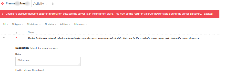

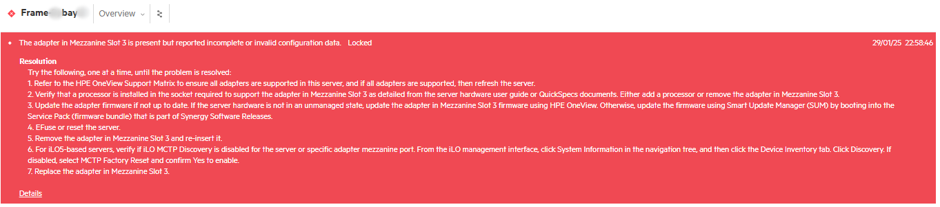

对于任何 HPE Synergy 480 Gen11 计算模块,在极少数情况下,在Mezzanine slot 3 中安装的任何适配器上执行固件更新后,HPE OneView 可能会显示类似以下内容的消息:
"Unable to discover network adapter information because the server is an inconsistent state. This may be the result of a server power cycle during the server discovery."
"The adapter in Mezzanine Slot 3 is present but reported incomplete or invalid configuration data."
