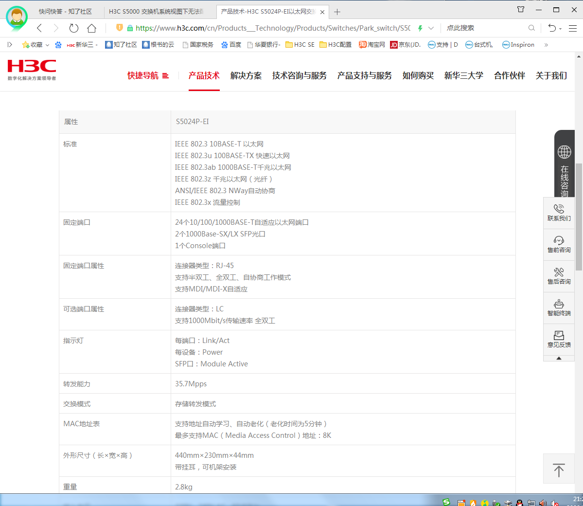

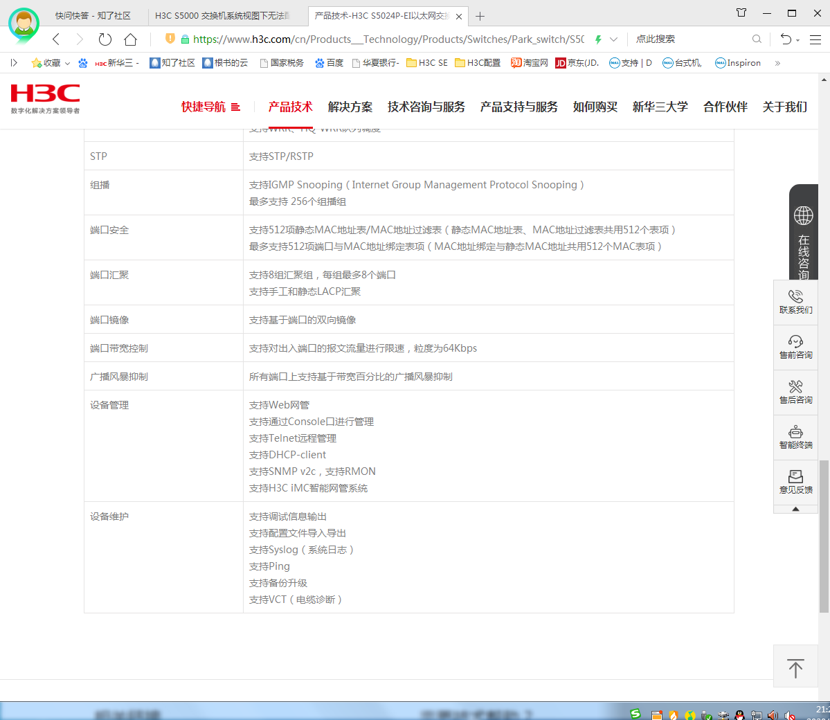

你好,根据官网资料显示,这是一个可网管的二层交换机
粉丝:19人 关注:0人
具体是什么设备呢
一念破土 知了小白
H3C S5024P Product Version S5024P-R0109
Copyright (c) 2004-2009 Hangzhou H3C Technologies Co., Ltd. All rights Reserved.
H3C S5024P uptime is 0 week(s),0 day(s),1 hour(s),59 minute(s)
H3C S5024P with 17M 8051 Processor
128K bytes SDRAM
2048K bytes Flash Memory
Config Register points to EEPROM
Hardware Version is Ver.1.0
Bootrom Version is 100
[Subslot 0] 24 GE(4 COMBO) Hardware Version is Ver.1.0
