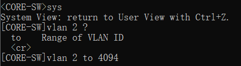

请问华三交换机6900怎样批量添加vlan
2020-11-06提问
  • 1收藏,8529浏览
跑跑 零段
粉丝:1人 关注:1人
vlan 2 to 4094
粉丝:11人 关注:1人
vlan 2 to 100
如果是批量创建VLAN,可参考如下配置命令:
vlan 2 to 10
如果是将VLAN批量划分到端口,可参考如下命令:
方法一举例:
[H3C]vlan 10   //创建VLAN
[H3C-vlan10]port gi 1/0/1 to gi 1/0/10   //直接划分到1口到10口
[H3C-vlan10]quit
[H3C]dis vlan 10  //查看VLAN的信息
 VLAN ID: 10
 VLAN type: Static
 Route interface: Not configured
 Description: VLAN 0010
 Tagged ports:   None
 Untagged ports:
    GigabitEthernet1/0/1          GigabitEthernet1/0/2
    GigabitEthernet1/0/3          GigabitEthernet1/0/4
    GigabitEthernet1/0/5          GigabitEthernet1/0/6
    GigabitEthernet1/0/7          GigabitEthernet1/0/8
    GigabitEthernet1/0/9          GigabitEthernet1/0/10
方法二举例:
[H3C]vlan 20  //创建VLAN 20
 [H3C-vlan20]quit
[H3C]int range gi 1/0/20 to gi 1/0/30  //批量进入20口到30口
 [H3C-if-range]port link-type access  //将端口配置为access模式
 [H3C-if-range]port access vlan 20   //将VLAN 20划分到20口到30口
[H3C-if-range]quit
[H3C]dis vlan 20  //查看VLAN信息
 VLAN ID: 20
 VLAN type: Static
 Description: VLAN 0020
 Tagged ports:   None
 Untagged ports:
    GigabitEthernet1/0/20         GigabitEthernet1/0/21
    GigabitEthernet1/0/22         GigabitEthernet1/0/23
    GigabitEthernet1/0/24         GigabitEthernet1/0/25
    GigabitEthernet1/0/26         GigabitEthernet1/0/27
    GigabitEthernet1/0/28         GigabitEthernet1/0/29
    GigabitEthernet1/0/30
