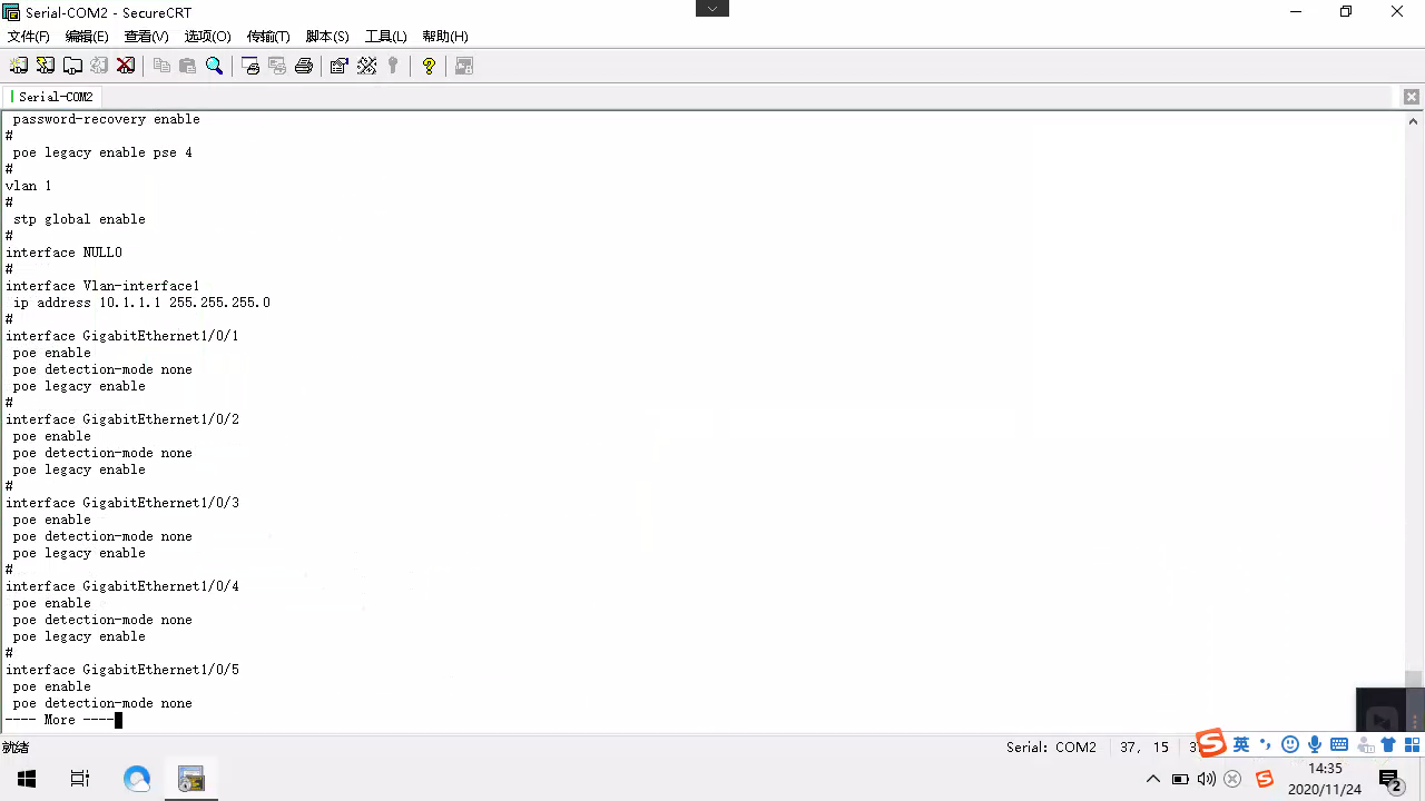

这个poe不供电该怎么结局啊?非标准pd检测也开了,在端口下也应用了还是供电不了

 display poe pse 、 display poe pse interface下有PD吗?

<H3C>dis poe pse 4 PSE ID : 4 Slot No. : 1 SSlot No. : 0 PSE Model : LSPPSE24B PSE Status : Enabled Power Priority : Low Current Power : 0.0 W Average Power : 0.0 W Peak Power : 0.0 W Max Power : 370.0 W Remaining Guaranteed Power : 370.0 W PSE CPLD Version : - PSE Software Version : 147 PSE Hardware Version : 57633 PSE Legacy PD Detection : Enabled Power Utilization Threshold : 80 PD Power Policy : Disabled PD Disconnect-Detection Mode : DC PD High Inrush : Disabled 有的

display poe pse interface呢

(W) Class Status GE1/0/1 Enabled Low 0.0 Off 0 Searching GE1/0/2 Enabled Low 0.0 Off 0 Searching GE1/0/3 Enabled Low 0.0 Off 0 Searching GE1/0/4 Enabled Low 0.0 Off 0 Searching GE1/0/5 Enabled Low 0.0 Off 0 Searching GE1/0/6 Enabled Low 0.0 Off 0 Searching GE1/0/7 Enabled Low 0.0 Off 0 Searching GE1/0/8 Enabled Low 0.0 Off 0 Searching GE1/0/9 Enabled Low 0.0 Off 0 Searching GE1/0/10 Enabled Low 0.0 Off 0 Searching GE1/0/11 Enabled Low 0.0 Off 0 Searching GE1/0/12 Enabled Low 0.0 Off 0 Searching GE1/0/13 Enabled Low 0.0 Off 0 Searching GE1/0/14 Enabled Low 0.0 Off 0 Searching GE1/0/15 Enabled Low 0.0 Off 0 Searching GE1/0/16 Enabled Low 0.0 Off 0 Searching GE1/0/17 Enabled Low 0.0 Off 0 Searching GE1/0/18 Enabled Low 0.0 Off 0 Searching GE1/0/19 Enabled Low 0.0 Off 0 Searching GE1/0/20 Enabled Low 0.0 Off 0 Searching GE1/0/21 Enabled Low 0.0 Off 0 Searching GE1/0/22 Enabled Low 0.0 Off 0 Searching GE1/0/23 Enabled Low 0.0 Off 0 Searching GE1/0/24 Enabled Low 0.0 Off 0 Searching --- On State Ports: 0; Used: 0.0(W); Remaining: 370.0(W) ---

都使能了

没有检索到受电PD,下面的PD正常吗?有能受电吗?
