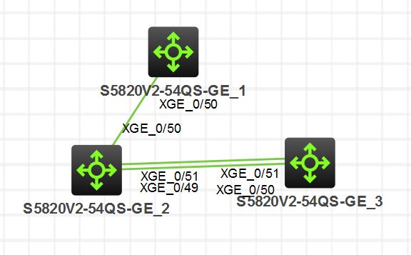

告警信息:
May 1 16:03:12:548 2018 H3C#2 RM/3/RMLOG: The default route has been deleted, protocol is OSPF, nexthop address is 192.168.1.14, output interface is Vlan-interface51
%May 1 16:03:59:640 2018  H3C#2   RM/3/RMLOG: The default route has been deleted, protocol is OSPF, nexthop address is 192.168.1.14  , output interface is Vlan-interface51
%May 1 16:04:05:233 2018  H3C#2  RM/3/RMLOG: The default route has been deleted, protocol is OSPF, nexthop address is 192.168.1.14  , output interface is Vlan-interface51
OSPF 邻居反复建立。
拓扑:
配置信息,如附件!
  H3C#1 ospf 100
 area 0.0.0.0
 network 192.168.1.0 0.0.0.3
 interface Vlan-interface50
 ip address 192.168.1.1 255.255.255.252
 ospf network-type p2p
 H3C#2 interface Vlan-interface51
 ip address 192.168.1.13 255.255.255.252
 ospf 100
 area 0.0.0.0
 network 192.168.1.12 0.0.0.3
 interface Bridge-Aggregation1
 port link-type trunk
 port trunk permit vlan 1 51
 interface Ten-GigabitEthernet1/0/49
 port link-mode bridge
 combo enable fiber
 port link-aggregation group 1
 interface Ten-GigabitEthernet1/0/51
 combo enable fiber
 H3C#3 ospf 100
 area 0.0.0.0
   interface Ten-GigabitEthernet1/0/50
 combo enable fibe
# interface Ten-GigabitEthernet1/0/51
 combo enable fiber
# interface Vlan-interface51
 ip address 192.168.1.14 255.255.255.252
