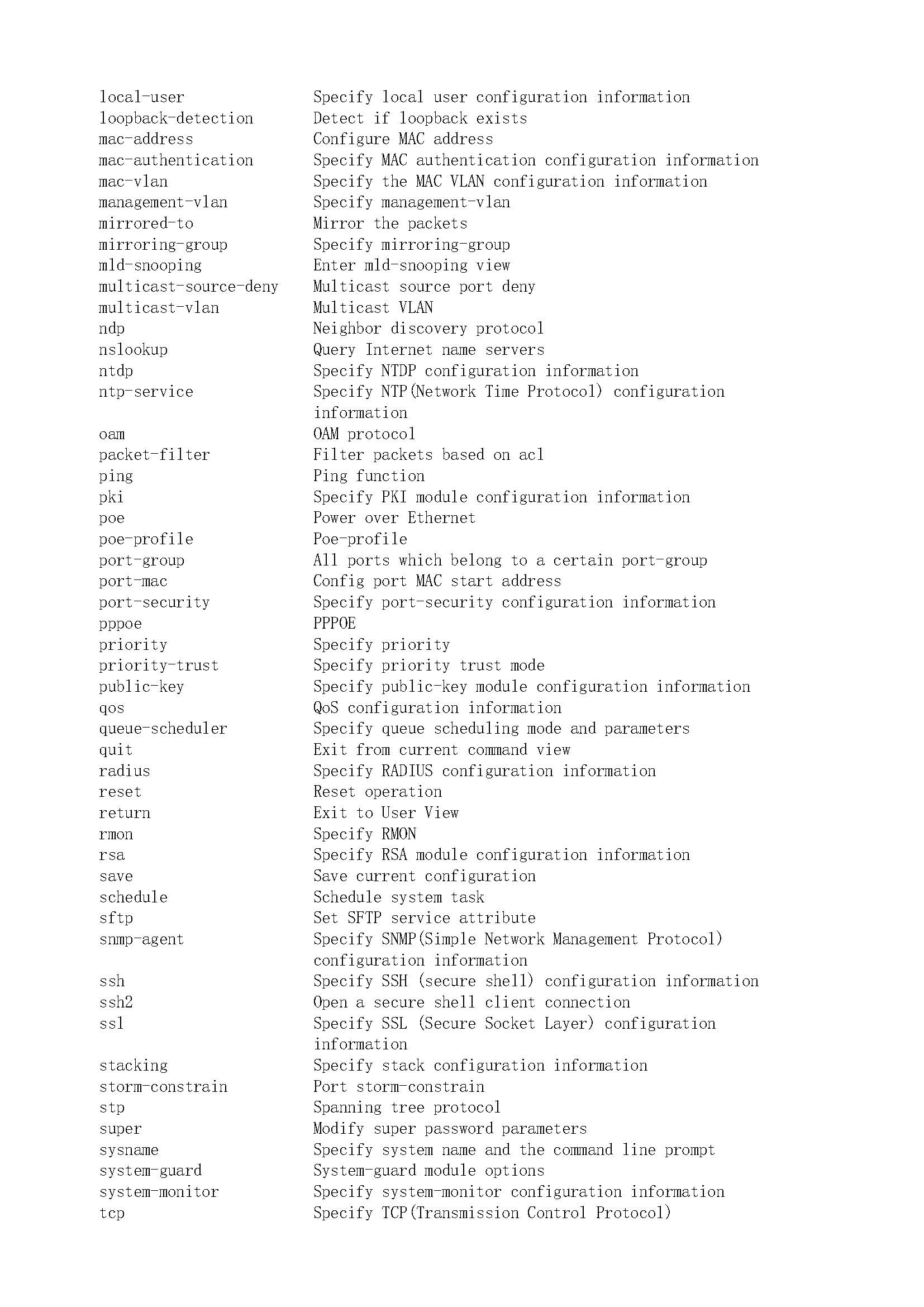

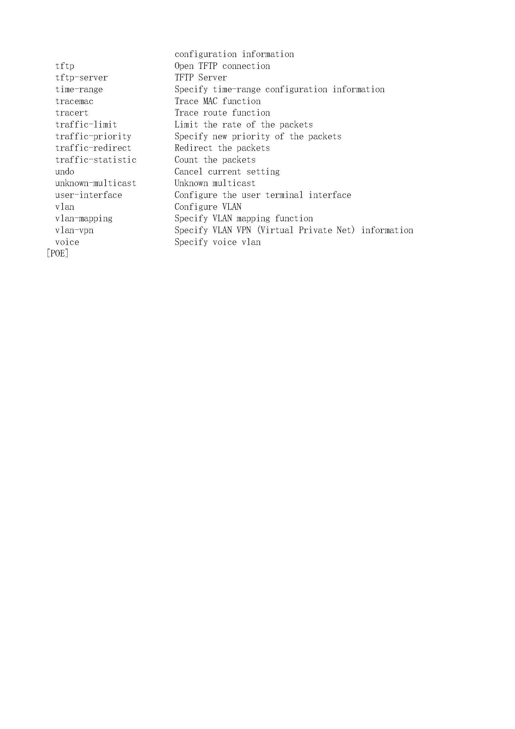

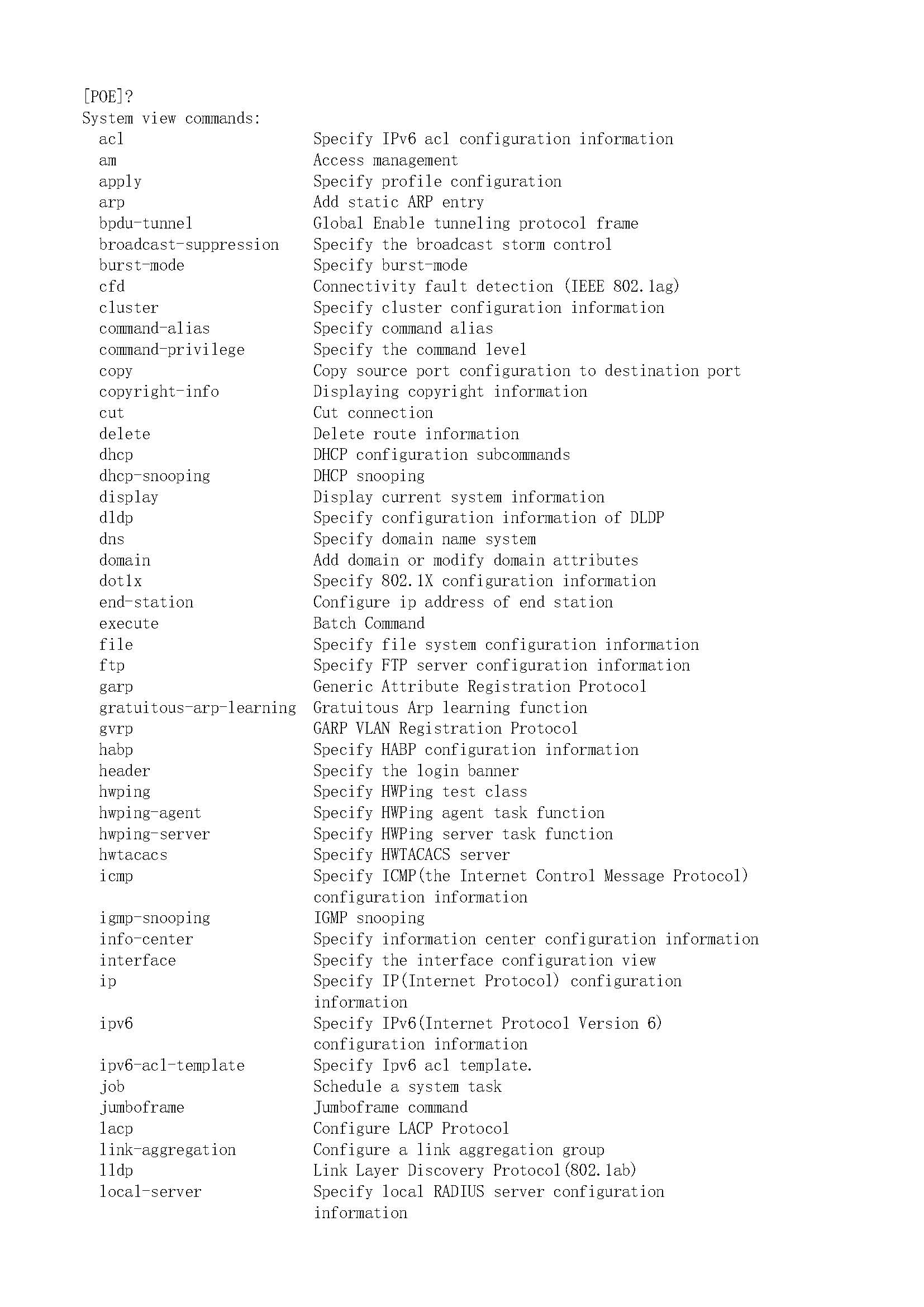

下面是设备反馈的所有指令,发现根本没有开启WEB的ip http shutdown或undo ip http shutdown,但是查询官网的WP2000无线注入器配置指导中是有这个功能的。

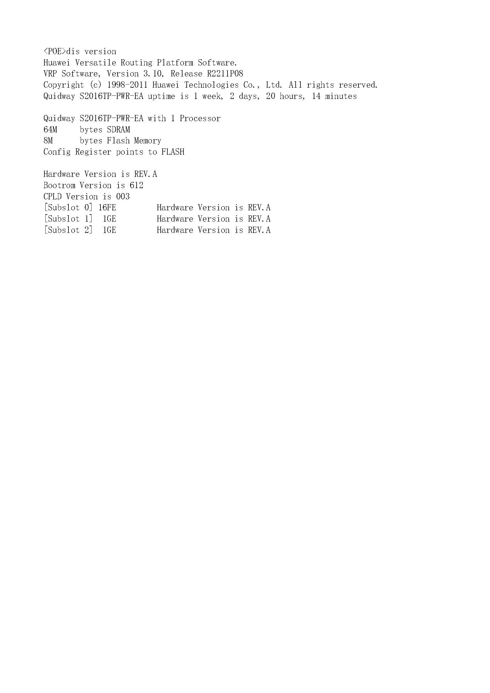

不应该啊 整个版本看看
漓离原上谱 发表时间:2020-11-25
<POE>dis cur # sysname POE # radius scheme system # domain system # local-user admin password simple admin service-type ssh telnet terminal level 3 # vlan 1 # vlan 100 # interface Vlan-interface1 ip address 192.168.0.254 255.255.255.0 # interface Aux1/0/0 # interface Ethernet1/0/1 poe enable port access vlan 100 # interface Ethernet1/0/2 poe enable port access vlan 100 # interface Ethernet1/0/3 poe enable port access vlan 100 # interface Ethernet1/0/4 poe enable port access vlan 100 # interface Ethernet1/0/5 poe enable port access vlan 100 # interface Ethernet1/0/6 poe enable port access vlan 100 # interface Ethernet1/0/7 poe enable port access vlan 100 # interface Ethernet1/0/8 poe enable port access vlan 100 # interface Ethernet1/0/9 port access vlan 100 # interface Ethernet1/0/10 poe enable port access vlan 100 # interface Ethernet1/0/11 port access vlan 100 # interface Ethernet1/0/12 port access vlan 100 # interface Ethernet1/0/13 port access vlan 100 # interface Ethernet1/0/14 port access vlan 100 # interface Ethernet1/0/15 port access vlan 100 # interface Ethernet1/0/16 port access vlan 100 # interface GigabitEthernet1/1/1 port link-type trunk port trunk permit vlan all # interface GigabitEthernet1/1/2 port link-type trunk port trunk permit vlan all shutdown # interface GigabitEthernet1/2/1 port link-type trunk port trunk permit vlan all shutdown # interface GigabitEthernet1/2/2 port link-type trunk port trunk permit vlan all # interface NULL0 # ip route-static 0.0.0.0 0.0.0.0 192.168.0.1 preference 60 # snmp-agent snmp-agent local-engineid 800007DB3822D6B716DE6877 snmp-agent community write writetest snmp-agent sys-info version all # user-interface aux 0 authentication-mode password set authentication password cipher .]@USE=B,53Q=^Q`MAF4<1!! user-interface vty 0 user privilege level 3 set authentication password cipher .]@USE=B,53Q=^Q`MAF4<1!! user-interface vty 1 4 # return
zhiliao_r6Cfjk 发表时间:2020-11-25
这。。
着是V3的还是早期的V3,换吧

http server enable ?
叫我靓仔 发表时间:2020-11-25
他都没有http这个指令
那估计就是不支持了,你看的哪里的文档

缺省开启WEB,你删除配置文件,重启看下,不行就真的不行了
文档中是写的有WEB管理的开启方式为<H3C> system-view [H3C] local-user admin [H3C-luser-admin] service-type telnet level 3 [H3C-luser-admin] password simple admin 且我设置了vlan1的IP地址 并配置了静态路由,现在能通过Telnel的方式在局域网内登录,就是WEB怎么都搞不起来
我通过reset saved-configuration恢复过出厂设置,也都还是不行
这个无解了
