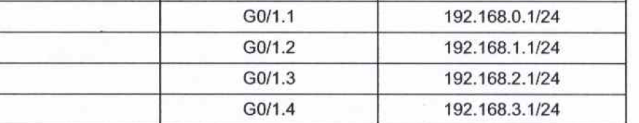

如下,在模拟器是怎么配置才会UP来的
interface GigabitEthernet0/1.1
ip address 192.168.0.1 255.255.255.0
