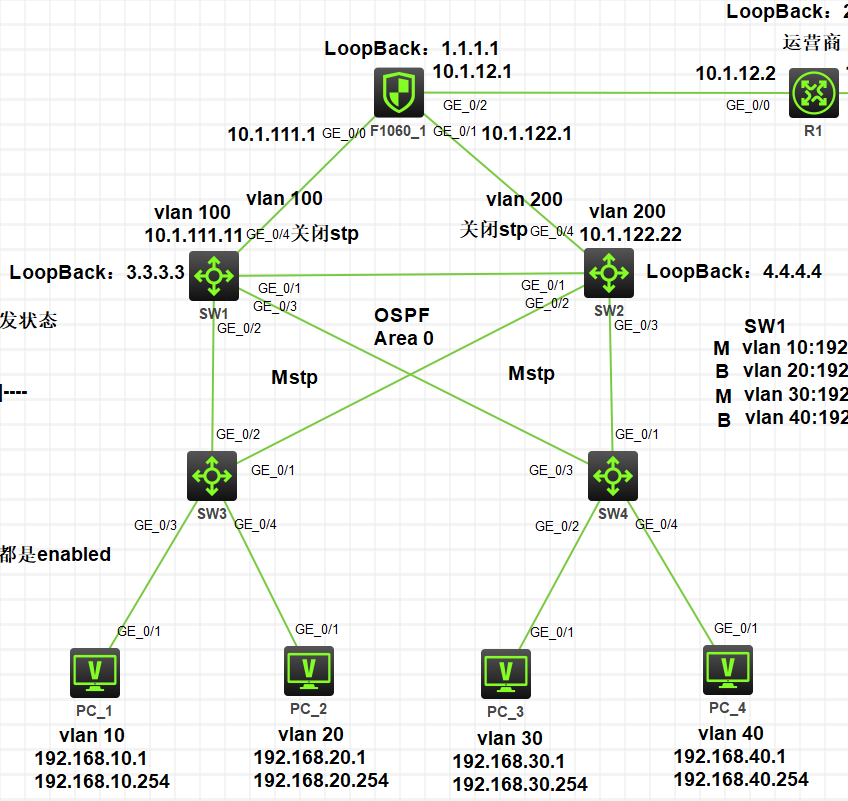

不知道是不是模拟器问题

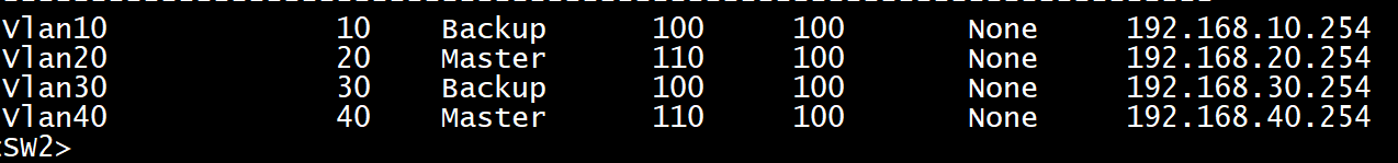

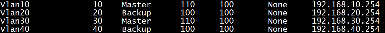

问题一:刚启动,防火墙1口频繁UP  DOWN(不是每次都这样,有时正常)
问题二:刚启动,SW1提示:
%Dec 3 11:27:09:204 2020 SW1 VRRP4/6/VRRP_STATUS_CHANGE: The status of IPv4 virtual router 10 (configured on Vlan-interface10) changed from Backup to Master: Preempt.
 %Dec 3 11:27:09:205 2020 SW1 VRRP4/6/VRRP_STATUS_CHANGE: The status of IPv4 virtual router 30 (configured on Vlan-interface30) changed from Backup to Master: Preempt.
SW2提示:The status of IPv4 virtual router 10 (configured on Vlan-interface10) changed from Master to Backup: VRRP packet received.
 %Dec 3 11:27:07:166 2020 SW2 VRRP4/6/VRRP_STATUS_CHANGE: The status of IPv4 virtual router 30 (configured on Vlan-interface30) changed from Master to Backup: VRRP packet received.
有时候提示是VLAN 20 和40  (也不是每次都这样,有时正常)
看到VRRP在切换,检查下VRRP的master优先级是否高于backup的优先级。
其次检查下MSTP的根桥是否稳定。注意VLAN的透传到位。
另外模拟器可能存在未知的问题,建议真机测试下。
粉丝:11人 关注:7人
检查你mstp的状态o
VRRP的抖动不会影响的上面OSPF的邻居关系,很可能是模拟器的问题
