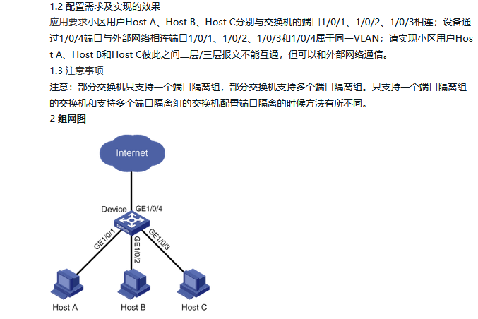

4 支持多个隔离组的交换机配置端口隔离
4.1 配置步骤
# 创建隔离组2。
<H3C> system-view
[H3C] port-isolate group 2
# 将端口GigabitEthernet1/0/1、GigabitEthernet1/0/2、GigabitEthernet1/0/3加入隔离组2。
[H3C] interface gigabitethernet 1/0/1
[H3C-GigabitEthernet1/0/1] port-isolate enable group 2
[H3C-GigabitEthernet1/0/1] quit
[H3C] interface gigabitethernet 1/0/2
[H3C-GigabitEthernet1/0/2] port-isolate enable group 2
[H3C-GigabitEthernet1/0/2] quit
[H3C] interface gigabitethernet 1/0/3
[H3C-GigabitEthernet1/0/3] port-isolate enable group 2
# 保存配置
[H3C] save force
# 显示隔离组2中的信息。
[H3C] display port-isolate group 2
 Port isolation group information:
 Group ID: 2
 Group members:
以上信息显示H3C上的端口GigabitEthernet1/0/1、GigabitEthernet1/0/2、GigabitEthernet1/0/3已经加入隔离组2,从而实现二层隔离,分别对应的Host A、Host B和Host C彼此之间不能Ping通。
