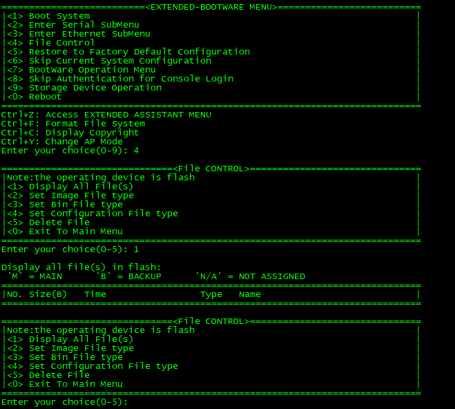

==========================<EXTENDED-BOOTWARE MENU>========================== |<1> Boot System | |<2> Enter Serial SubMenu | |<3> Enter Ethernet SubMenu | |<4> File Control | |<5> Restore to Factory Default Configuration | |<6> Skip Current System Configuration | |<7> BootWare Operation Menu | |<8> Skip Authentication for Console Login | |<9> Storage Device Operation | |<0> Reboot | ============================================================================ Ctrl+Z: Access EXTENDED ASSISTANT MENU Ctrl+F: Format File System Ctrl+C: Display Copyright Ctrl+Y: Change AP Mode Enter your choice(0-9): 4 ===============================<File CONTROL>=============================== |Note:the operating device is flash | |<1> Display All File(s) | |<2> Set Image File type | |<3> Set Bin File type | |<4> Set Configuration File type | |<5> Delete File | |<0> Exit To Main Menu | ============================================================================ Enter your choice(0-5): 1 Display all file(s) in flash: 'M' = MAIN 'B' = BACKUP 'N/A' = NOT ASSIGNED ============================================================================ |NO. Size(B) Time Type Name | ============================================================================ ===============================<File CONTROL>=============================== |Note:the operating device is flash | |<1> Display All File(s) | |<2> Set Image File type | |<3> Set Bin File type | |<4> Set Configuration File type | |<5> Delete File | |<0> Exit To Main Menu | ============================================================================ Enter your choice(0-5):
zhiliao_NlTtkl 发表时间:2021-01-14
一点文件都没有
zhiliao_NlTtkl 知了小白
就是没有文件,他还跳空间不足
