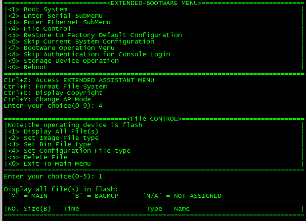

格式化后,文件都没了,重新传一下版本试试

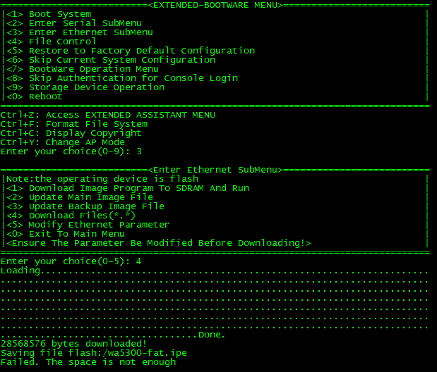

没办法了 传.bin格式显示Something wrong with the file. 传.ipe显示空间不足 Download Image Program To SDRAM And Run 倒是能成功 Loading file wa5300-oasis-boot.bin...Done! Loading file wa5300-oasis-system.bin...Done! Image file wa5300-oasis-boot.bin is self-decompressing...................... ............................................................................ ............................................................................ ............................................................................ ............................................................................ ...................Done. System image is starting... Startup configuration file doesn't exist or is invalid. Line con0 is available. 内存里面跑着

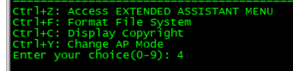

Ctrl + F  格式化存储试试

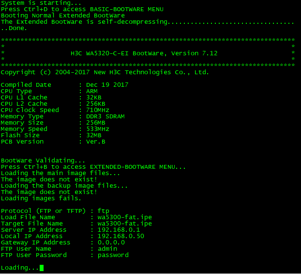

现在上电显示 BootWare Validating... Press Ctrl+B to access EXTENDED-BOOTWARE MENU... Loading the main image files... The image does not exist! Loading the backup image files... The image does not exist! Loading images fails. 是不是没救了

试了显示success但是重来一遍还是空间不足

上电自启就一直卡在loading。。。
