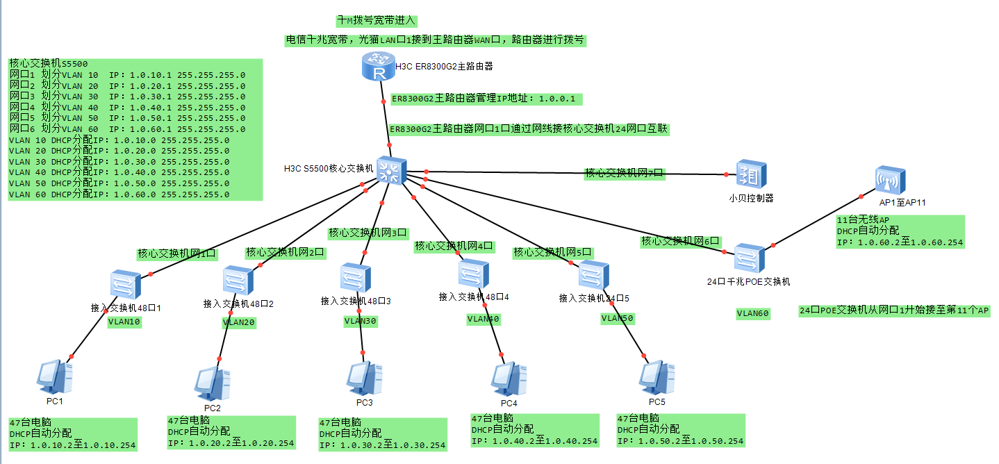

设备:
路由器一台 ER8300G2
控制器一台MSG360-20
无线AP  11台 WAP722-W2-FIT
核心交换机 一台S55002-28-C-EI
接入交换机4台 MINI S1248 48口
接入交换机1台 MIN  S1224R 24口
POE交换机1台 S1226F-HPWR  24口
1、电信宽带1000M接入,电信光猫千兆网口1连接至H3C ER8300G2主路由器的WAN1口,进行拨号上网。
2、H3C ER8300G2主路由器LAN1通过网线接至H3C S5500核心交换机24网口。
3、H3C S5500 网口1-7口划分7个VLAN
5、H3C S5500 网口1 划分VLAN10 IP:1.0.10.1 255.255.255.0    创建地址池:1.0.10.0  255.255.255.0  1.0.10.1  114.114.114.114
6、H3C S5500 网口2 划分VLAN20 IP:1.0.20.1 255.255.255.0    创建地址池:1.0.20.0  255.255.255.0  1.0.20.1  114.114.114.114
7、H3C S5500 网口3 划分VLAN30 IP:1.0.30.1 255.255.255.0    创建地址池:1.0.30.0  255.255.255.0  1.0.30.1  114.114.114.114
8、H3C S5500 网口4 划分VLAN40 IP:1.0.40.1 255.255.255.0    创建地址池:1.0.40.0  255.255.255.0  1.0.40.1  114.114.114.114
9、H3C S5500 网口5 划分VLAN50 IP:1.0.50.1 255.255.255.0    创建地址池:1.0.50.0  255.255.255.0  1.0.50.1  114.114.114.114
10、H3C S5500 网口6 划分VLAN60 IP:1.0.60.1 255.255.255.0    创建地址池:1.0.60.0  255.255.255.0  1.0.60.1  114.114.114.114
11、H3C S5500 网口7 划分VLAN70 IP:1.0.70.1 255.255.255.0    创建地址池:1.0.70.0  255.255.255.0  1.0.70.1  114.114.114.114
后面操作流程就不会,那位大神帮帮忙忙,麻烦详细配置方法提供我学习一下,能加微信最好13357182750,提供一些补偿
交换机VLAN、DHCP的配置参考如下:
将交换机的名字修改为SW1:
[H3C]sysname SW1
在交换机分别创建VLAN 10、VLAN 20:
[SW1]vlan 10
[SW1-vlan10]quit
[SW1]vlan 20
[SW1-vlan20]quit
VLAN 10的IP设置为:192.168.10.1 255.255.255.0:
[SW1]int vlan 10
[SW1-Vlan-interface10]ip address 192.168.10.1 24
[SW1-Vlan-interface10]quit
VLAN 20的IP设置为:192.168.20.1 255.255.255.0:
[SW1]int vlan 20
[SW1-Vlan-interface20]ip address 192.168.20.1 24
[SW1-Vlan-interface20]quit
将GI1/0/1端口划分到VLAN 10:
[SW1]int gi 1/0/1
[SW1-GigabitEthernet1/0/1]port link-type access
[SW1-GigabitEthernet1/0/1]port access vlan 10
[SW1-GigabitEthernet1/0/1]quit
将GI1/0/2端口划分到VLAN 20:
[SW1]int gi 1/0/2
[SW1-GigabitEthernet1/0/2]port link-type access
[SW1-GigabitEthernet1/0/2]port access vlan 20
[SW1-GigabitEthernet1/0/2]quit
开启DHCP功能:
[SW1]dhcp enable
创建DHCP地址池,命名为VLAN10,分配网段、子网掩码、默认网关、DNS:
[SW1]dhcp server ip-pool vlan10
[SW1-dhcp-pool-vlan10]network 192.168.10.0 mask 255.255.255.0
[SW1-dhcp-pool-vlan10]gateway-list 192.168.10.1
[SW1-dhcp-pool-vlan10]dns-list 114.114.114.114
[SW1-dhcp-pool-vlan10]quit
[SW1]
创建DHCP地址池,命名为VLAN20,分配网段、子网掩码、默认网关、DNS:
[SW1]dhcp server ip-pool vlan20
[SW1-dhcp-pool-vlan20]network 192.168.20.0 mask 255.255.255.0
[SW1-dhcp-pool-vlan20]gateway-list 192.168.20.1
[SW1-dhcp-pool-vlan20]dns-list 114.114.114.114
[SW1-dhcp-pool-vlan20]quit
交换机与路由器可配置三层互联,其次配置相应的路由发布或指向。
最后配置路由器的上网接入、路由指向。
以下是ER8300G2的用户手册链接:
https://www.h3c.com/cn/Service/Document_Software/Document_Center/Routers/Catalog/H3C_ER_G2/ER8300G2/
